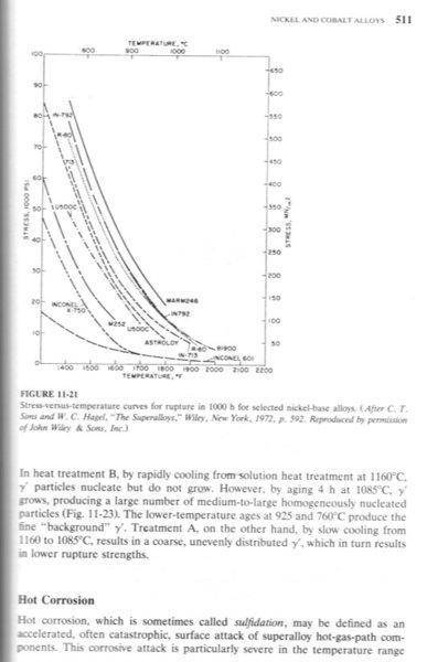

Hello,
I am developing an analytical approach to determine the creep constants of a constitutive model for nickel-base superalloys.
I require creep strain versus time data to valid my approach.
I've searched through literature and have found very little usable data.
I need creep strain versus time data at 3 stress levels for 3 temperatures (9 tests).
Does anyone know where I could obtain this type of data?

Any poly-crystalline nickel-base superalloy while do. I'm trying to develop a generalized approach which would work for most Ni-base superalloys (tertiary creep dominant materials).
In particular, I've been looking at Hastelloy X, Inconel 617, and Nimonic 80A? (I have some existing data for these materials but not enough for a full study)
Does this help?

Nice summary here of the alloys mentioned.
http://www.ewp.rpi.edu/hartford/~barthc2/EP/Other/Archive%20PDF%20Files/report11-28.pdf
Code:
              C      Fe     Ni    Cr    Co    Ti    Al    Mo    others
Hasteloy X   0.07   18.0   bal   22.0  12.5    -     -    9.0   0.6W
Inconel 617  0.07    -     bal   19.5   -     0.4   1.0   9.0   -
Nimonic 80A  0.08    -     bal   12.0   -     2.2   1.4    -    -
Hasteloy X is Ni-Cr-Fe-Co, while Inconel 617 is Ni-Cr-Mo and Nimonic 80 is Ni-Cr with 2nd phase particles if Ti and Al (moreso than 617).
There is an ASM reference book entitled, Atlas of Creep and Stress-Rupture Curves, which may have some plotted curves.
http://hts.asminternational.org/portal/site/www/AsmStore/ProductDetails/?vgnextoid=ad13e7c40209e110VgnVCM100000701e010aRCRD
and this might have some data
http://www.nrc.gov/reading-rm/doc-collections/nuregs/contract/cr6824/cr6824.pdf
and possibly in this
www.iaea.org/inisnkm/nkm/aws/htgr/fulltext/iwggcr4_16.pdf
and on can browse this book:
Superalloys: a technical guide
By Matthew J. Donachie, Stephen James Donachie
http://books.google.com/books?id=vjCJ5pI1QpkC
Otherwise, there are several journals on metals, such as Metallurgical Transactions
Meanwhile, I look to see what I have on these particular alloys
Astronuc,
Thank you for finding some relevant information.
The first paper has some background information on the materials.
The ASM atlas of creep I've already checked and didn't find much useful data.
The NRC Paper has a lot of good information.
I will look in the library for the "Superalloys" book.
I'm still search for more strain vs time curves.
Thanks
