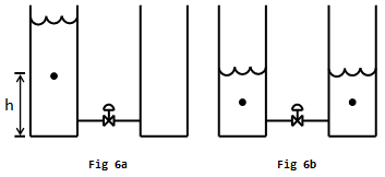

When you share charges between two identical capacitors (by letting half of the charges in one capacitor to spill to the other) the over energy is halved. Where does that energy go? In what way is it lost?

But in what form is the energy "lost?"This is a similar situation using water tanks:
The potential energy in Fig6a is Ea = mgh. The potential energy in Fig6b is Eb = 2( (0.5m)g(0.5h) ) = 0.5 Ea. Half of the potential energy is lost.
When an object freefall, potential energy is converted into kinetic energy. So there is no net lost of energy. But where did the energy go in the case of the water tank? Is it true that the energy is still lost through kinetic energy, because, if the water must obviously move to get to the second tank, and while it is moving, there is additional kinetic energy (aside from its temperature), which the water gets from its potential energy?
What about the case of the capacitors? Is the energy lost simply because the charges moved (they moved because the potential energy gave them kinetic energy to move down the gradient)?
Does the energy lost have anything to do with electromagnetic radiation?
The energy is lost to thermal energy (via resistive heat generation in the first case and turbulent and frictional heat generation in the second case). I noticed you drew the water levels as equal in your Fig. 6b instead of having all the water rush to the right side (with no loss of energy) then all back to the left side (again, with no loss of energy); so at some level (maybe not explicitly), you've assumed that damping exists in the system. The same thing applies to the voltage in the capacitor problem; by assuming the voltages end up as equal, you're implying an irreversible system, which means that energy will be thermalized.
