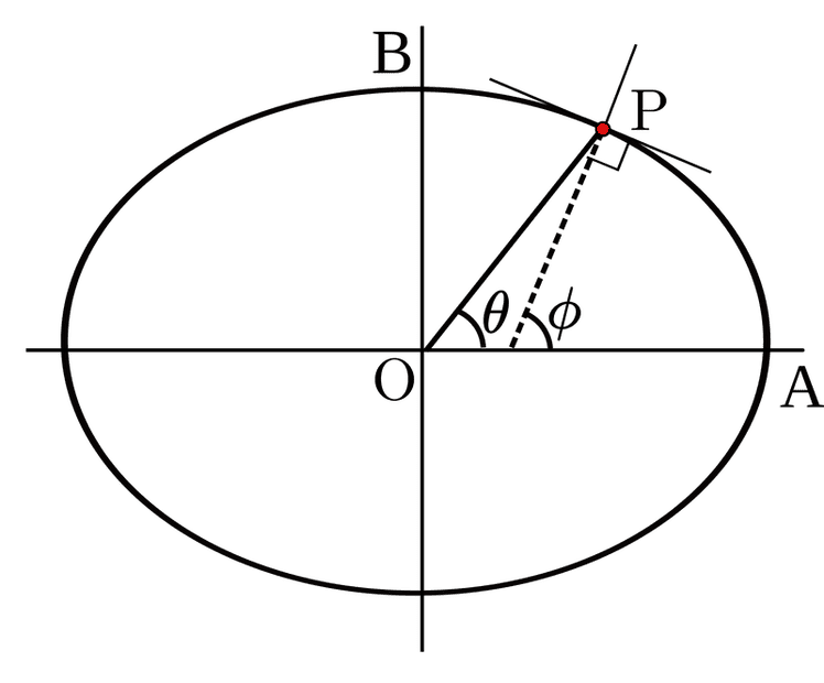

A while ago, I wrote a computer program to track satellites based on their orbital elements (not dissimilar to what heavens-above.com implements). The program does not take GR into account and models orbits as Kepplerian. I still had to model ground locations (i.e., observing locations) based on Earth being a oblate spheroid, not a sphere. Had I modeled Earth as a sphere, it would have caused significant pointing errors. To elaborate, there are several different types of latitude: geocentric latitude and geodetic latitude, being most used. It's often important to distinguish between the two (or any other type). (See more: https://en.wikipedia.org/wiki/Latitude#Auxiliary_latitudes.)
Geodetic latitude ( \phi) and geocetric latitude (\theta).
If I'm not mistaken, most maps use geodetic latitude which takes into account the Earth being an ellipsoid. So that's another application where the Earth's oblateness is considered: maps.
