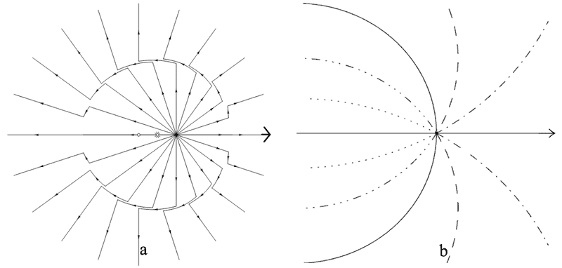

Amaterasu21 said:
Maxwell's equations tell us an accelerating charge produces EM radiation.
Not if the acceleration is constant, and we are in the rest frame of the charge. Then you just have a constant but distorted E-field (Figure b), as opposed to radiation for changing acceleration (Figure a).
From: https://arxiv.org/abs/1503.01150
For hyperbolic motion there is radiation after all, but a comoving observer cannot observe the radiation. There's a nice AJP paper by Franklin and Griffiths investigating this (in)famous problem very thoroughly. It underlines the importance of taking Dirac-##\delta##-like contributions into account properly and to be aware of the specialty of this situation, where the asymptotic in and out state of the particle's motion are to approaching the speed of light. In this case a naive application of the Lienard-Wiechert potentials is tricky:
