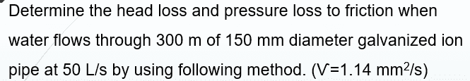

there are 2 formula of vont karman and prandit laws to find the friction factorfor rough pipe and smooth pipe , which formula should i use for this question?
Text reads: Determine the head loss and pressure loss to friction when water flows through 300 m of 150 mm diameter galvanized iron pipe at 50 L/s by using following method. (V=1.14 mm2/s)
Two Prandtl-von Karman friction factor equations side by side: smooth pipe, 1/sqrt(f) = 2 log(Re sqrt(f) / 2.51); rough pipe, 1/sqrt(f) = 2 log(3.7 / (e/D)).
P/ s : I'm asked to find the friction factor using the vont karman and prandit laws.
it didnt stated whether it's smooth or rough pipe , which formula should we use?
I was going to propose you do both (assuming some reasonable ##e## for galvanized ion pipe ) and compare ... :smile:
On the other hand, you do have the data to calculate Re so I certainly wouldn't leave out that one...

well , i have found that the f for rough pipe is 0.017 , nut i am not sure how to find f for smooth pipe using von karman and Prandlt laws ... for smooth pipe , i have 1 / ( surd f ) = 2 log [(3.72 x 10^5) (surd f ) / 2.51 ]
P/ s: by using scientific calculator , i get the f for smooth pipe is 0.014 , which value should i choose ? f= 0.017 or 0.014 ?
