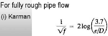

one more question , is roughness ratio = e / D ? or e only ? P/s : in this question , i was given that the roughness ratio = 0.008 , i am not sure this refer to e or e / D , can someone clarify ?
Table of absolute roughness coefficient k for pipe surfaces, in metres (10^-3) and feet (10^-5 to 10^-3), e.g. copper 0.001-0.002, steel commercial pipe 0.045-0.09, ordinary concrete 0.3-1.
i need e / D to find the friction factor
Text reading 'For fully rough pipe flow, (i) Karman' followed by the equation 1/√f = 2 log(3.7/(e/D)).
P /s : this is turbulent flow , pls ignore my 32 μL(kinematic viscocity) / ρg(D^2) earlier .
Table of absolute roughness coefficient k for pipe surfaces, in metres times 10^-3 and in feet, listing copper, PVC, stainless steel, commercial steel, cast iron, concrete and wood values.
Text reading 'For fully rough pipe flow' and '(i) Karman', followed by the equation 1/√f = 2 log(3.7/(ε/D)).
The absolute roughness ε is usually measured in mm. The relative roughness (ε/D) is non-dimensional.
I think in the table above, the absolute roughness coefficient k should just be the absolute roughness.
The roughness ratio of 0.008 you were given for this pipe suggests that the absolute roughness was taken from the middle of the "new cast iron" range of the table above, which is conservative.
EDIT: Corrected comment about the roughness ratio of the pipe.

so , it should be / (surd f ) = 2log ( 3.7 / 0.008 ) ?
Yes.
