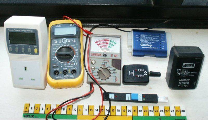

Set of meters and testers standard in my field case.
The ruler at bottom is 300cm or 1 foot long
From left to right along top
Mains power tester displays power, voltage, current, frequency & power factor.
Multimeter
The multimeter does, volts, amps, resistance, transistors, diodes, temeprature, humidity, light flux, sound intensity, semiconductor tests, continuity.
Battery tester applies dedicated loads, has spring loaded coin cell fitting.
Computer psu tester
Second row
Battery eliminator tester and polarity indicator accepts various jacks
Mains socket wiring checker checks line neutral & Earth for correct operation
Third row
Telephone socket and line function tester.

Nice set of meters!
Actually the DT-21 (2nd from the left) does retail for $100, but can be found down to $60:
http://www.metershack.com/electrica...mometer-light-humidity-sound-multi-meter.html

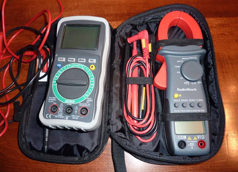

My work-horse is an Extech that I bought at Radio Shack. Less than $60 at the time. It does everything I need with acceptable accuracy. My electronic interests generally involve vacuum-tube circuits where Fluke accuracy isn't required.
I recently found a need for a clamp-meter and ended up paying $80 for such a meter with fewer overall capabilities than the Extech.
