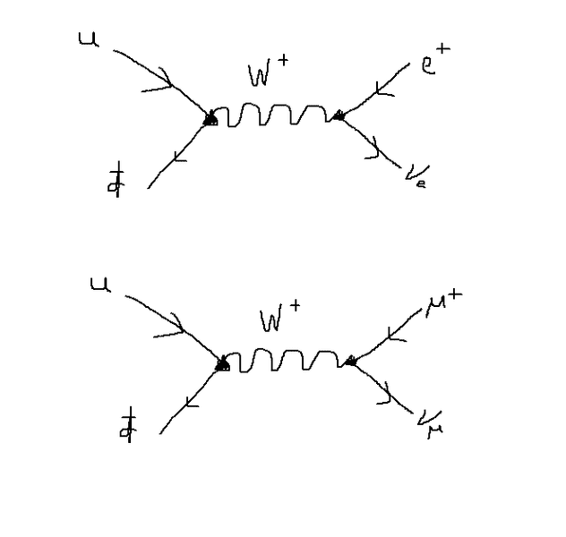

Draw feynman diagrams for pi+ muon lepton decay and suggest which process is more likely.
[/B]
The feynman diagrams are:
The lepton decays proceed via the weak interaction W+ boson. This implies that e+ should be right-handed and neutrino is always left-handed. In the rest frame of W+, we get:
But this implies that total spin = 1, which is not true. Therefore, e+ must be left-handed?
Is the electron massless?

Helicity is the projection of the spin on the momentum. According to the restframe of the W+, the electron neutrino is left-handed and the positron is right handed. But as pointed above, total J = 0, so this must be untrue.
For a particle with mass, we can always go into a frame whereby the particle is moving left/right while the helicity remains unchanged. This implies helicity is not conserved in weak interactions as Z0 and W+ bosons have mass. For massless particles, there is no rest frame.

Helicity is the projection of the spin along the linear momentum of a subatomic particle. Chirality is the innate handedness of a particle. The weak interaction couples to negative chirality particle and positive chirality antiparticle states.
The Pi+ has a Jp state of 0- and, hence, its decay products also have to have a combined J of 0. Their spins have to anti-align. Now the neutrinos is produced in a negative chirality state and as it is massless it also has negative helicity (left handed). As we need the antilepton's and the neutrino's spin to anti-align, it also needs to be left handed (negative helicity). However, the weak force only couples to positive chirality antiparticles. Therefore, the electron has to be boosted in order to turn a positive chirality into a negative helicity. It the lepton was massless, this boost wouldn't be possible and the decay would be forbidden.
The muon is a lot heavier than the electron, so this boosting is a lot harder. Hence, Pi+ -> v_mu mu+ happens more often than Pi+ -> v_e e+.
