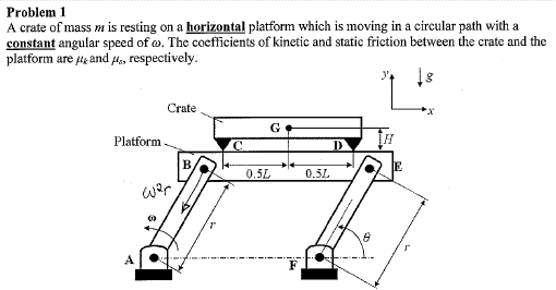

Here is the problem:

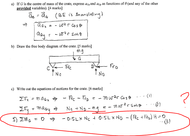

Here is the solution:
I am confused about part c.
Here is my attempt at part c:
I don't get why the answer key solution sums the moments about point G. I decided to sum up the moments about C and D and found out both normal forces are 0.5mg. However I quickly find out this is wrong because I am unable to solve the rest of the problem (which I did not include).
