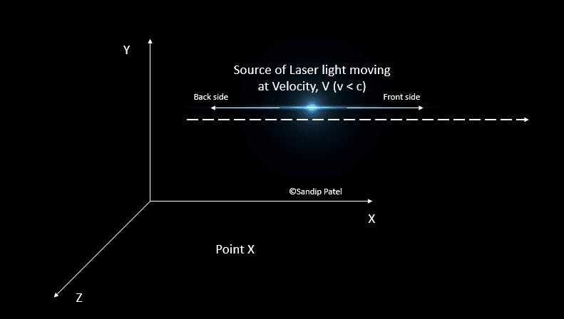

Let me simplify the question further that is the base of time dilation.
One object has laser source at front side (s1) and back side (s2). If that source travels from point X at the speed (v) near to the speed of light (v < c), where the front side is towards the direction of the motion and back side is at the opposite direction of the motion. What is the speed of light at front side (s1) and back side (s2) with reference to point x? Consider that all events are in same frame.
I have no idea what you are asking except the bolded part and I am flummoxed that you can be in any doubt what the answer to that is. The speed of light is c (assuming your setup is in a vacuum). Period.
These two statements appear to be contradictory.
If the laser source is moving, then it is not in the same frame as x.
From which frame would you like to describe your observations?Also, as phinds points out, the only answer to "what is the speed of light (in a vacuum)?" is "c", regardless of any qualifiers you might add.
More to the point: Why do you think it would be different?

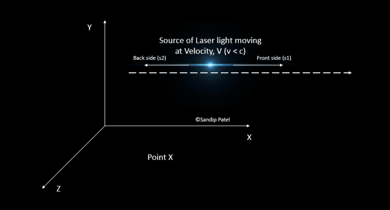

Please refer below image for better understanding.
My question was what is the speed of light at s1 and s2 when the source is moving at speed (v) where v < c and near to c?
An outside "stationary" observer sees both lights traveling forward and backward at the same speed, c. The question is how a traveling observer can also measure equal speeds, c, in both directions. The answer is that, from the stationary point of view, his clocks are set wrong in the forward direction and are set with the opposite errors in the backward direction. So all the traveling measurements show the relative speed of light to be the same in both directions. The traveling measurement of distance is also distorted (with the same distortion in both directions) in a way that makes the speed exactly c in both directions.
c, always.
c. As I said. It's a postulate of relativity. As I also said, look up the Lorentz transforms. You can use them to understand all SR problems, and if you don't use them you'll probably never understand.
