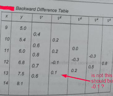

Here is the backward difference table given in my book
https://prnt.sc/n2965l
240773
But it seems this table is wrong. I have marked my comment in the screen.
Can you please tell who is right ?

(1) Yes, you are right.
(2) Isn't that a forward-difference table?
Whether it is a forward or backward difference table depends on how you allign entries. Since the table has the differences half way between the terms they subtract you can view them as forward differences (next row's entry minus this row's) by assuming the rows slant downward to the left. Letting the rows slant upward allows you to call them backward differences (this row's entry minus the previous row's).

Whether it is a forward or backward difference table depends on how you align entries.
And on how you label them - the columns here are labelled ## \nabla, \nabla^2 ... ## which by convention refers to backward differences i.e ## x_n - x_{n-1} ## (forward differences ## \Delta ## being ## x_{n+1} - x_n ##).
Ok, I failed to look at the column labels---that is, I thought they were ##\Delta##, etc.
However, to me the table looks weird; over many decades of viewing tables, I have never seen tables that you read from bottom to top; reading from top to bottom seems to be almost a universal convention (albeit undocumented), rather like that of reading from left to right in Western languages.
