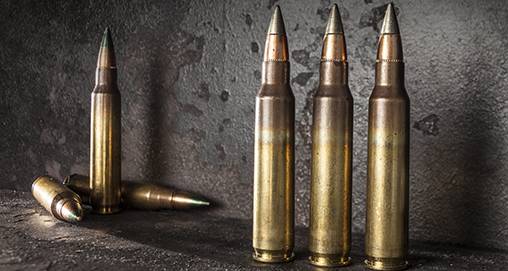

This is the gist of it, but there are some important details. It's not the point at the front of the bullet that matters so much, as the point of the hardened armor piercing core (usually steel, occasionally tungsten carbide). US Military body armor and the highest level hard law enforcement armor are tested with the M2 AP round on the far right in the above photo. When the bullet impacts armor, the copper and lead parts of the bullet in front of the steel core are quickly flattened and the contact between the pointy core leads the armor penetration.
Layered armors have a hard outer layer (usually ceramic) designed to shatter or flatten or break the pointy tip off of the core. Of interest to armor and bullet designers and testers are the "close calls" in which the bullet is barely stopped or barely penetrates. In cases where the bullet barely penetrates, it is usually the rear of the core (with the point broken off) that makes it through. Likewise, this is what makes it deepest into armor layers when it is stopped. But other materials (hardened steel or brick or cinder block) will also often break off the pointy tip early in the penetration. So it may be debatable how important the pointy tip really is. Notice the hirtenberger design does not have one.
We conducted tests a few years back for one defense-related company where we ground the points off the AP M2 bullet cores (far right) before shooting them into various armor designs. They still penetrated really well. Consequently, I suspect that the hardness and mass and velocity of the steel core plays a bigger role than the frontal area of the point.
Newer AP bullet designs (the M855 A1, see picture below, and the M80 A1) keep the pointy penetrator, but have moved it to the very front. But in real life, the goal is not only to maximize armor penetration, but also to reduce cost, reduce weight, and increase effectiveness in living targets.
