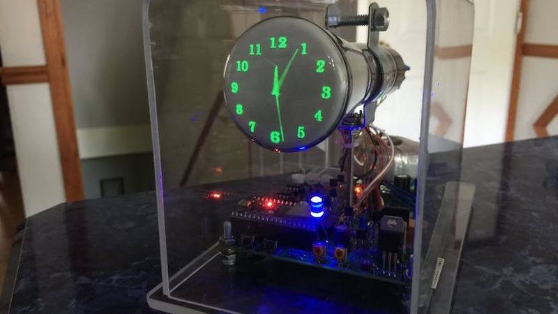

link

Rive said:
With that, it is only a few years of serious electronics practice and you may attempt to DIY something based on an old oscilloscope tube.
That is not a raster display like a TV, it is a vector plotter. You can just see the trace of the beam, as it moves from one symbol to another on the screen.
Yes. More math, less electronics. A nice fit here, I think.
link
Pretty cool. :smile:
BTW, did he mention why the display moves slightly every few seconds? I only quick-skimmed the middle of the video and skipped to the end result. At first I thought there was a glitch in the deflection circuitry, but then I realized that he probably did it on purpose. :wink:
Likes Rive
The trace of the beam shows that the drive waveform doesn't go far enough to get below a believable black level. A fairly good CRT driver won't allow visible frame flyback lines to be seen - although I have seen the effect on a faulty CRT. If the bandwidth of the drive is high enough to give those crisp characters then is it fundamental that trace between characters would be seen? I don't think so.
Edit: the scanning system must have been a nightmare - electrostatic - but they used it in many specialist vector displays.
Maybe Z-mod is not being used, to keep the sparks out of the microcontroller. The differential deflection plates for X and for Y, would be about ground potential, within the grounded aquadag.
An opto-isolator might be used to cross the gap between the grounded microcontroller, and the negative EHT of the CRT cathode - grid1, maybe 1.5 kV ?
Notice how the brightness of the trace indicates the direction of travel, since the output of the X and Y axis D-A converters, settle together, exponentially towards the next symbol.
It would look better if the point of departure from a previous symbol, was close to the next symbol, and the start point of the next symbol was on the far side of the widest part of the next symbol. That would cross the gap quickly, then have time to settle in the brighter area of the next symbol.
A suitable driver would do that. I'm surprised that the z mod seems not to be good enough to suppress visible flyback lines when in normal 'scope' mode. Or maybe the demo was considered to work well enough without specific flyback suppression. It can hardly be fundamental to the tube. OR . . . . they deliberately left the flyback lines visible to make it obvious that it was a vector image and not a raster.
