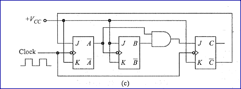

I am following the book Digital Principles and Applications by Malvino, Leach and Saha.
Under the heading "Decade Counters", the book lists only Mod-5 and Mod-10 counters. It doesn't state why these are decade counters, or what decade counters are. Others like Mod-8, Mod-3, Mod-6 etc. are listed outside that heading.
All the counters are using JK flip-flop in this book. While I know that other flip-flops can be used to make the counters, I request you to stick to JK flip-flops, because I am new to this topic and am already confused.
For reference, here is the diagram of the Mod-5 up counter given in my book (outputs are A, B and C; C is the MSB, while A is the LSB.):

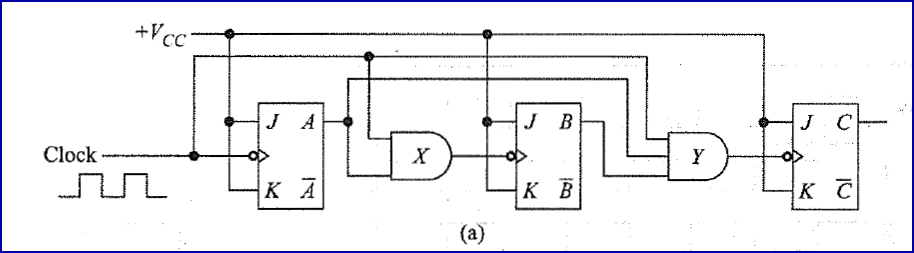

and here is the Mod-8 up counter (outputs are A, B and C; C is the MSB, while A is the LSB.):

This makes things confusing for me. How can something count in decimals? Consider the Mod-5 counter above. It goes from 000 to 100. Isn't that counting in binary rather than decimal?
Speaking the other way round, the Mod-8 counter goes from decimal 0 to 7. I can easily get the output in decimal if I decode the necessary outputs. So why is it not a decade counter?

According to this definition, a Mod-5 counter doesn't qualify as a decade counter because it has five states, from decimal 0 to 4.
So, why are Mod-10 and Mod-5 decade counters and Mod-6 and Mod-8 not? Or is the book incorrect? Or am I misinterpreting something?
