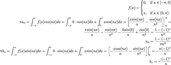

I'm trying to get Fourier series for some function however I get the same nonsense series each time:
[tex] f(x)=\begin{cases}<br /> 0, & \mbox{if x $\in [-\pi,0]$}\\<br /> x, & \mbox{if x $\in (0,\pi)$} \end{cases}[/tex]
[tex] \pi a_n=\int_{-\pi}^\pi f(x)cos(nx)dx=\int_{-\pi}^0 0 \cdot cos(nx)dx+\int_0^\pi xcos(nx)dx=\left.\left[\frac{xsin(nx)}{n}-\frac{cos(nx)} {n^2}\right]\right|_0^\pi[/tex]
[tex] =\frac{\pi sin(n\pi)}{n}-\frac{cos(n\pi)} {n^2} - \frac{0 sin(0)}{n}+ \frac {cos(0)} {n^2}=\frac {1-(-1)^n}{n^2}[/tex]
[tex] a_n=\frac{1-(-1)^n}{\pi n^2}[/tex]
[tex] \pi b_n=\int_{-\pi}^\pi f(x)sin(nx)dx=\int_{-\pi}^0 0 \cdot sin(nx)dx+\int_0^\pi xsin(nx)dx=\left. \left[-\frac{xcos(nx)}{n}-\frac{sin(nx)}{n^2}\right] \right|_0^\pi=-\frac{\pi (-1)^n}{n}[/tex]
[tex] b_n=-\frac{(-1)^n}{n}[/tex]
WolframAlpha suggests that I wrongly calculated the integral, however I used well know theorem:
[tex]\int p(x)f(x)dx=p \cdot F_1+p' \cdot F_2...[/tex]
That last minus should be a plus; that's all that is wrong.
Sorry but I don't understand why.
if p(x) is polynomial and f(x) is continues in I then:
[tex]\int p(x)f(x)dx=p(x)F_1+p'(x)F_2[/tex] where F_1 is integral of f(x) and F_2 is the integral of the integral of f(x)
p(x)=x, p'(x)=1
f(x)=cos(nx)
[tex]\int f(x)=F_1=\frac{sin(nx)}{n}[/tex]
[tex]\int F_1=F_2=\frac{-cos(nx)}{n^2}[/tex]
Thus: [tex]\int xcos(nx)=\frac{sin(nx)}{n}-\frac{cos(nx)}{n^2}[/tex]
That formula is incorrect. That + should be a -.
Actually, there is more than that wrong with it. If F(x) is an antiderivative of f(x):
[tex]\int p(x)f(x)\, dx = p(x)F(x) -\int p'(x)F(x)\, dx[/tex]
Oh this is embarrassing mistake...
Thanks [again]!
