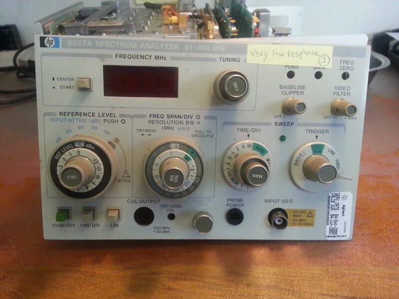

User interfaces don't often get the attention they deserve. Why, in the last half century did Tektronix own the oscilloscope market compared to HP? It wasn't performance, it was the front panel.

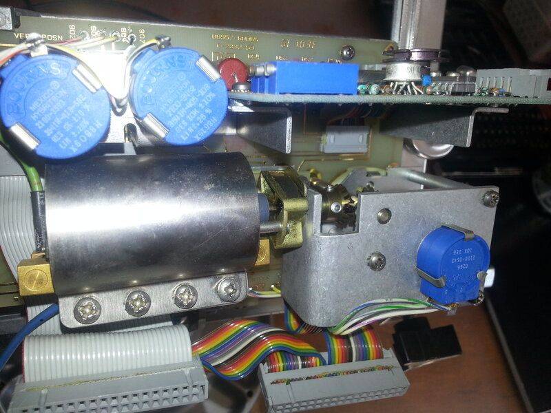

If you ever get the opportunity to take apart a 1960-1990 era instrument with a significant user interface, it's worth the effort, IMO. The mechanical packaging design, manufacturing engineering, and component design is impressive. OTOH, there sure are a lot of things that could break.
I guess I'm showing my age, but I'd much rather set the resolution BW this way than on a touch screen.

Looking inside that HP explains a lot. That's a lot of steel just to hold a knob. And I can't say I've ever seen a circuit board mounted to angle bracket, or bevel gears mounted on a potentiometer :oldlove: (or encoder, or whatever it is). I think I see what you mean lol. Thanks for sharing!
Most of these instruments are (much) older than I am, but I'm still with you. Honestly, if the bean counters at tektronix want to cut costs, they should just have a USB port for a wireless mouse (trackball mouse, doesn't need any extra room or a mousepad). Nowhere near as quick and easy as an all-knobs-and-buttons interface, but I'd take a mouse over touchscreens.
