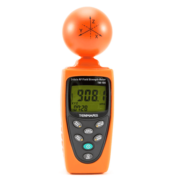

I would like to consult with you about something. Mobile phone towers transmit at relatively high frequencies. From a health perspective, on the internet :) all measurement values are interpreted in microteslas. However, with the Wavecontrol probe (WPF8) I have, only the electric field (E) can be measured. In fact, all of the company's high-frequency measurement probes can only measure the electric field. Is this a limitation? Is it pointless to measure the H value? Or can we calculate the H value through a general calculation like (H = E * 377)?

Antennas are modelled based on the currents that flow in the conductors. Those currents generate magnetic fields that are summed in different directions to establish the far-field pattern of the antenna. That is why the magnetic field is specified for a transmit antenna.
I suspect the probes used with the Wavecontrol instruments are interfaced to the meter through a known impedance, probably 50 ohm. It is the voltage appearing in that impedance, that is reported. Wavecontrol also make a couple of H-probes. Most probes are quoted as having a range of; V/m, and an equivalent; A/m.

At a distance of just a few wavelengths from an antenna, the wave propagates as if it's a plane wave in free space. The fields closer in are only of interest for health and safety.
The H field and the E field are at right angles to one another and the impedance of EM waves in free space is
{\displaystyle Z_{0}={\frac {|\mathbf {E} |}{|\mathbf {H} |}},}
which is about 377Ω. You can measure either but measurements of E are usually preferred at frequencies of more than a few tens of MHz because it's very convenient to use and calibrate a short dipole probe. For longer wavelengths , the local impedance and fields are often very 'site specific' and subject to local bits of metal. The impedance can be very variable. Magnetic probes are often. used here because measurements often tend to be more reliable (not affected by the user, holding the meter etc.)
mV/m tends to 'mean something' to Engineers, more than H fields. I'm sure there are exceptions to that statement; EE is a wide and varied topic!
