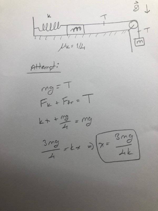

Hello, I am new on this forum, so if I make any mistakes please inform me. Thank you.
I wonder why I cannot use forces instead of energy conservation in this question.

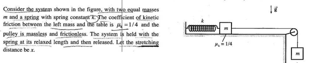

The question is:
"How far (x = L) does the spring stretch before the masses stop moving? Express your answer in terms of m, k and some constants as needed."
Physics diagram of two masses connected by a spring on a horizontal table, with a pulley at the right edge and a hanging mass m; labelled k for the spring, mu_k = 1/4 for the table friction, and g pointing down.
Here is my attempt but of course it is wrong (I imagined the last situation which is equilibrium), the answer should be (3mg)/2k:
Handwritten sketch of a block of mass m on a horizontal surface with coefficient of kinetic friction 1/4, attached to a spring of constant k on the left and a string over a pulley to a hanging mass m on the right, with tension T labelled; below it are handwritten force equations mg = T, Fk + Ffr = T, kx + mg/4 = mg, and the boxed result x = 3mg/4k.
Because once released, the hanging mass will drop beyond the equilibrium point. You are solving for the maximum stretch, not the equilibrium position. (At least that's what I presume they are asking for.)
I think the problem is the difference between the coefficient of kinetic and static frictions, but I will think about that. Thank you

Doc Al said:
(I see no mention of static friction here.)
At final, it will stop moving, so there will not be any kinetic friction, it will be static friction I guess. But the only given quantity is about coefficient of kinetic friction so that when I try to use "Force equality" it gives me a wrong answer.
If you interpret the question as I did, you'll get the "right" answer. :wink:
Until it has stopped moving, at least instantaneously, it is kinetic friction. So static friction has no relevance to how far it moves. You would need to know the static friction if you wanted to find out whether it then starts to move back again.
That's because that method overlooks the momentum built up during the expansion of the spring.
If, instead, you wanted to know how far away you could carefully position the mass without its then moving to the left you would have used spring force balancing static friction.
