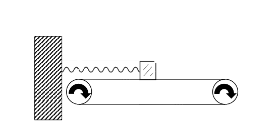

A box of mass m is placed on a treadmill. The box is connected to a stationary wall to the left via. a sping. The dynamic coeffecient of friction between the box and the treadmill is mu_k and the sping constant is k. The treadmill moves to the right. How far will it stretch the spring (assuming it is unstreched before we start)
Newtons laws, Energy conservation
First i show the sketch of the setup:
Diagram of a block attached by a horizontal spring to a vertical wall on the left, resting on a conveyor belt that runs over two pulleys, each with a curved arrow showing rotation.

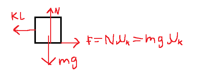

My first attempt was just to balance out the forces on the box. On the sketch below i have shown the situation where the spring is stretched distance L.
Free-body diagram of a box with spring force KL pointing left, normal force N up, weight mg down, and friction f = Nμk = mgμk pointing right.
In this situation we get the equations:
Three equations: N - m g = 0; f - k · L = 0; f = μk · N.
Which when solved leads to
Equation L = m g μk / k, with L on the left and a fraction on the right whose numerator is m g μk and denominator is k.

I can't really see why the two methods do not yield the same result and why my solution is incorrect. Any suggestions?

One problem in your "energy" approach is assuming that the friction force on the box equals ##\mu_k mg## from the start. But the friction force starts at zero, increasing as the spring stretches, until it reaches a maximum of ##\mu_k mg##.
Up to the point where the two forces balance the friction is larger than the elastic force so the box accelerates. At the equilibrium point it has some speed and KE. So it keeps moving, until this KE is dissipated. The body oscillates around the equilibrium position you found yourself. Their answer is the maximum position.

The question is not fully defined.
If we suppose the belt goes from rest instantaneously to a speed v then the box will slip immediately. The frictional force exerted by the belt is ##\mu mg##, so long as the box has not reached speed v.
This will lead to SHM, as @nasu notes, but if ##v<\mu g\sqrt{\frac mk}## then at some point the box will reach speed v and the frictional force will decline to ##kx##. The box will then continue at speed v until ##kx=\mu mg##.
At one extreme, v is very small and the box quickly matches the belt speed. Assuming static and kinetic coefficients are the same, the maximum stretch is given by ##kx=\mu mg##, as in your own solution.
At the other extreme, ##v>\mu g\sqrt{\frac mk}##, the box reaches twice that distance

How about ignoring how the block was started or whether is it oscillating and focus on the situation where the spring maintains a final fixed constant length. In the steady-state, the power dissipated as heat by friction is provided by the potential energy stored in the spring:$$\begin{align} & \frac{dU}{dt}=f_k v \nonumber \\
& kxv=\mu_k mgv \implies x=\frac{\mu_k mg}{k}. \nonumber \end{align}$$As @haruspex indcated, anything goes when one considers the transient behaviour.
