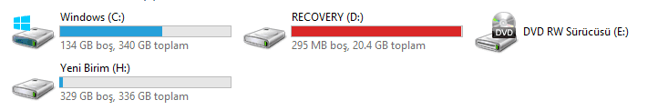

I have made some editions blindly to my SD card. Now the PC cannot perceive the disk. I cannot see the disk under my computer but can see under device manager. What's the matter? What is the reason?
Windows Explorer drive list showing Windows (C:) with 134 GB free of 340 GB, RECOVERY (D:) with 295 MB free of 20.4 GB, DVD RW Sürücüsü (E:), and Yeni Birim (H:) with 329 GB free of 336 GB.

  • Windows Explorer drive list showing Windows (C:) with 134 GB free of 340 GB, RECOVERY (D:) with 295 MB free of 20.4 GB, DVD RW Sürücüsü (E:), and Yeni Birim (H:) with 329 GB free of 336 GB.

Since I cannot see under my computer, I don't know? How can I check it in this case?

Since this is windows, try going into administrative tools / computer management / disk management and see what that displays. Similar to what you posted, it will show capacity (total space) and free space for all "drives".

Go into "Disk Manager" and see if you can see the disk there. Most probably it does not have a drive letter attached to it. Let Disk Manager assign a station letter to it, then it should be visible.
Could you please clarify if your computer cannot see the SD card, or some other disk?
If it is the SD-card, then you most likely damaged the file system on the SD-card with that 'blind edit', whatever does that mean.
The device manager checks the device itself, while the 'My computer' will see only intact, accessible file systems: devices without recognized filesystem won't show up.
Hopefully you don't have anything important on that card.
Do you want to use it again, or you want to recover the data on it?
