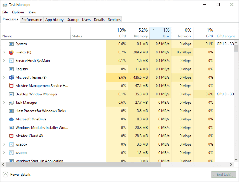

Under the Processes tab in Task Manager it should show you what process is using the disk currently. Laptops also tend to come with lots of "Bloatware," extra software installed by the manufacturer that no one cares for or uses, a removal of unused software can help in these cases.
Task Manager should tell you what is using the disk in the Processes tab so it's the best place to check when your having issues and you can google any results to see what that process does.

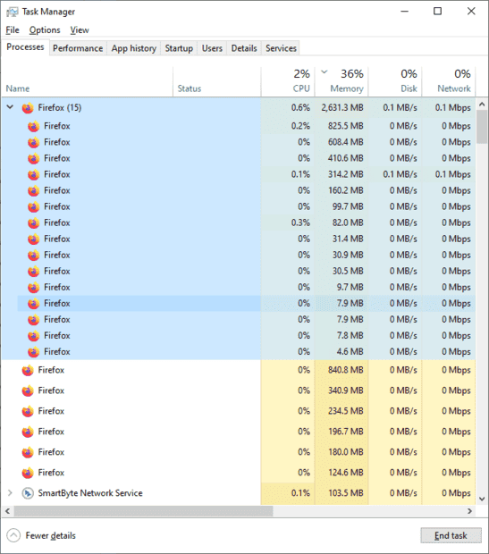

I am more suspicious of the memory usage by Firefox. Here is my current usage with just one Firefox window and 6 tabs open. That alone totals more than 4.5 GB. I don't know what is going on with it.

Sorry, Mike, I didn't catch that detail when I saw 78% RAM usage.
@FactChecker - I notice Firefox does open a lot of 'windows' (15 in your pic) despite one window being open with maybe two tabs (mine is currently at Firefox(7) and that's with two tabs open). I don't know why. It certainly does hog limited resources.
I also notice whenever Firefox updates, it takes some time to reload websites after the software has restarted and updated. Or that could be because I'm suffering other issues.
That 78% memory usage has never been very compatible with Windows usability. Cut back on the number of things you try to do at once, or get more memory!

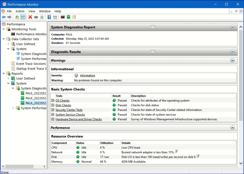

What you need to do when disk usage is high is to open the disk tab in the "Resource Monitor". It can tell you which process is reading which files but you might have to play around with the sorting of the columns to get the data you need presented in a useful way. The "Total (B/sec)" column is often useful.
You can open the "Resource Monitor" from the Performance tab in the Activity Monitor (or just search for it).
