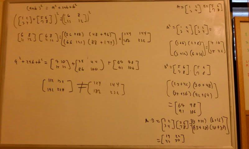

And Ray here is my work, would you agree that the reason they could not be equal is due to the 2ab term?

[ IMG]http://i45.tinypic.com/2ajxki0.jpg[/PLAIN]
In particular compare AB with BA .
So what I did was incorrect?
What you did was fine, and yes, it is the 2AB that messes you up.
Did you compare AB with BA ? --- to see why it's the 2AB that messes you up ?
I did AB and compared it to BA they are different. This I understand, what I don't understand is what that has to do with 2AB?
Or is what your saying is that in order to show that something is 100% true we must look at both cases. For instance A2 no matter what will be A2. Same thing goes with B, and A+B will be the same as B+A. However 2AB does not equal 2BA therefore it can't possibly be equal.

Re. your comment in red above. Expand ##(A+B)(A+B)## symbolically the long way (distributive law) being careful about the order. What do you get?
Not quite sure what you mean, it says math processing error
Do it just by manipulating the A and B's with a pencil and paper. Expand (A+B)(A+B).
Oh I see now A2+AB+BA+B2.
So making AB+BA=2AB that is implying that AB=BA which means you would be able to add them and get 2AB which is incorrect because AB does not necessarily equal BA.
Yup, that's right.
