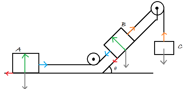

1. Homework Statement
3 blocks A,B and C are attached between them by massless and frictionless strings , that passes through frictionless , massless pullies , the blocks A and B have the same weight 25 N and the same coefficient of kinetic friction 0.35 , the bloc C goes down with a constant speed .
Using Newton's 2nd law we get : [tex]a_{C} = 0[/tex] because the speed is constant ,
what I can't figure out is why in the correction they said that : [tex]a_{B} = 0[/tex] and [tex]a_{A} = 0[/tex]
why both of block A and B have ALSO a zero acceleration , how do we know that ?
Free-body diagram of three blocks A, B and C connected by strings over pulleys: A on a horizontal floor, B on an incline at angle θ, C hanging vertically, with force arrows for weight, normal, tension and friction.
They are attached by a string to C, meaning that they cannot get further from C. But because they would slide to the other side, they cannot get closer to C. Thus, they will be equally far from C. This means that they don't accelerate.
why being equally far from C means that they don't accelerate , they could be equally far but their speed is increasing so accelerating .
But you know that c isn't acclerating. So it goes with a constant velocity (v) at any time. But B and A have to have the same velocity at any time, because as you said:
mamadou said:
being equally far from C.
So A and B have to have v at any time. But v is constant => no acceleration
does it means that A and B have the same velocity as C ?
truthly no , because there is also friction that acts on A and B , so how could they have the same velocity ?
okay. so:
if you have a train, with coaches connected to each other with "ropes", all coaches have the same velocity, right?
A and B cannot be slower because the rope is inextensible, right?
