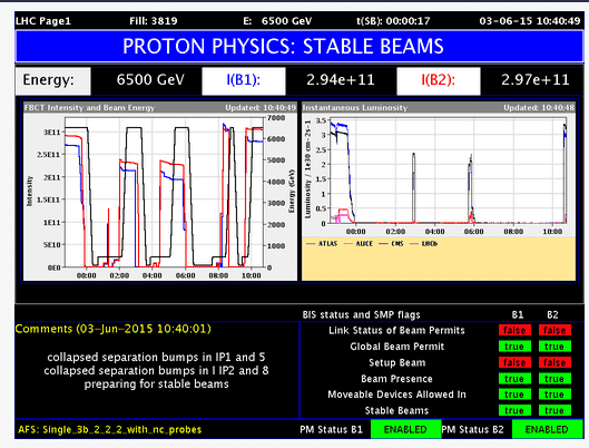

Yeah!
LHC control room screen titled Proton Physics: Stable Beams, showing Energy 6500 GeV, beam currents of 2.94e11 and 2.97e11, intensity and energy plots, instantaneous luminosity plot, and BIS status table with Stable Beams marked true.
Stable Beams: True.
About 70/nb both for ATLAS and CMS. There should have been a few Higgs bosons in those collisions (the expected number is ~7)!
It's just impossible to identify them with such a small dataset.

Some acronym translations?
BCT
TED
TDI
BIS
SMP
What indicates a collision in the trend.

No idea what the letters stand for:
BCT is related to the transfer lines (for injection).
TED/TDI are related to collimators and other settings for the beam position.
BIS/SMP: Gives an overview over the machine status.
The current collision rate can be seen at LHC operation: "Instantaneous luminosity". The design luminosity in those units is 10000/(μb*s), today we had 3/(μb*s).
