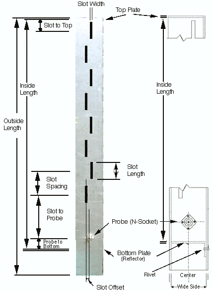

That's not what I am familiar as a patch antenna
what you described is a slotted waveguide
these are patch antennas ...
so what type of antenna are you really talking about ?

1) My question is if we have standing waves, in my mind we would have a max reflection (=1) on the magnetic walls so how comes we have leakage if we have full reflection on the wall ??
The leakage of signal is not through the open or conductive reflector but from the part of the resonant cavity exposed through a slot or aperture in the cavity wall.
A resonant dipole has full reflection at both ends and maintains a standing wave. Yet it still transmits a 2.15 dBi signal broadside.
