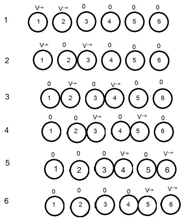

That question came from one of the students in my classical mechanics class, it took me unprepared at first but was able to give the correct answer in like half a minute. They liked it a lot and it initiated a useful discussion about laws of nature extending even to some particle physics concepts like Compton scattering. So I wanted to share it here also... Tutors don't give the answer so quickly please :smile:
The famous Newton cradle: You have several balls hanging. You release one from left, it hits the balls and the rightmost one launches. Everybody has seen this. Now, another case. You release 2 balls together from the left and you observe that 2 balls launch from right. The question is WHY? Why not a single ball from right but two to be more clear...

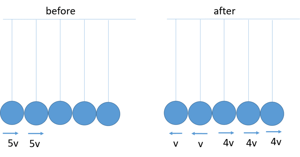

Ok, for momentum and energy arguments here is a configuration which conserves both momentum and energy... :smile:
243954
Likes gmax137 and Dale

You have to solve both: ##2m\vec{v}=m\sum_k \vec{v}_k## and ##m\vec{v}^2=\frac{m}{2}\sum_k \vec{v}_k^2##
Yes, but you have 2 equations and 5 unknowns, so there will be multiple solutions. One such solution is shown by @erbahar in post 7. This is a valid solution, but I have never seen it happen, so there is something more than just conservation involved.

As has been noted, the "perfect" Newton's Cradle result requires a small separation so that no three balls are in contact simultaneously. On the other hand, I suspect my model exaggerates the discrepancy by ignoring the time it takes for the shock wave to traverse a ball.
Two assumptions:
1. The balls ARE touching.
2. The spheres are PERFECTLY rigid.
Then it seems we have to conclude that those assumptions are so oversimplifying for this problem that it can not be solved?
Not a good assumption. That leads to infinite forces.
Such idealisations - inextensible strings, perfect elasticity etc. - are only valid as asymptotic limits. E.g. if we let the spring constant of a string be k, solve, let k tend to infinity and find the solution converges, then we can argue we have the solution for a string of negligible extensibility.
In the present case, that is what I did at the link I posted. The end result does not depend on the value of k, so represents the limit as the spheres tend to perfect rigidity.
