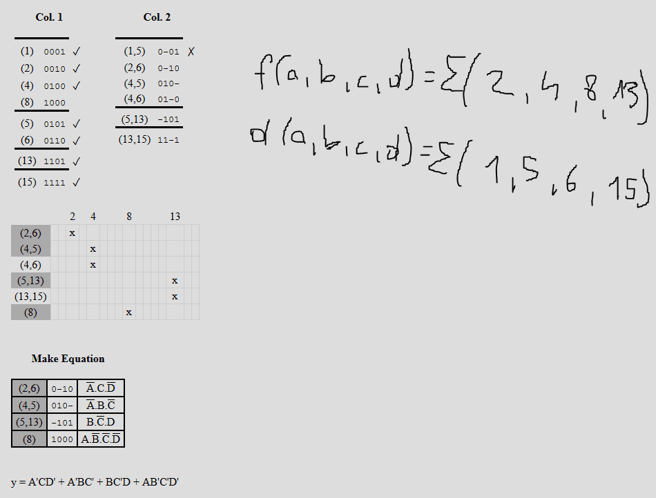

Hello,
can anyone tell me why do we take 4,5 and 5,13 instead of 4,6 and 13,15?Thats QM method

The wikipedia article summarizes it pretty well:
https://en.wikipedia.org/wiki/Quine–McCluskey_algorithm
Not really understanding how it works yet, could the choices be due to fewer bit variations?
basically 4,5 is ##(0 1 0 -)## and 5,13 is ##(- 1 0 1)## with the middle bits ##(-10-)## in common to both?
whereas 4,6 which is ##(01-0)## and 13,15 is ##(11-1)## only have the ##(-1--)## bit in common.

To find the essential prime implicants, we run along the top row. We have to look for columns with only 1 "X". If a column has only 1 "X", this means that the minterm can only be covered by 1 prime implicant. This prime implicant is essential.
For example: in the first column, with minterm 4, there is only 1 "X". This means that m(4,12) is essential. So we place a star next to it. Minterm 15 also has only 1 "X", so m(10,11,14,15) is also essential. Now all columns with 1 "X" are covered.
The second prime implicant can be 'covered' by the third and fourth, and the third prime implicant can be 'covered' by the second and first, and neither is thus essential. If a prime implicant is essential then, as would be expected, it is necessary to include it in the minimized boolean equation. In some cases, the essential prime implicants do not cover all minterms, in which case additional procedures for chart reduction can be employed. The simplest "additional procedure" is trial and error, but a more systematic way is Petrick's method. In the current example, the essential prime implicants do not handle all of the minterms, so, in this case, one can combine the essential implicants with one of the two non-essential ones to yield one equation:
