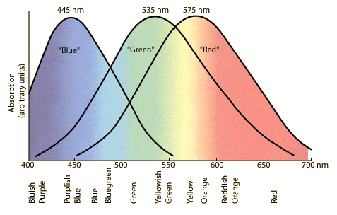

each colour receptor responds to all wavelengths, but in unequal amounts
the response is a sort of bell curve, with a maximum in the red green or blue

... there are three types of color-sensitive cones in the retina of the human eye, corresponding roughly to red, green, and blue sensitive detectors.
The Color-Sensitive Cones

We actually have an idea how. Another picture claiming to be the graph of human visual pigment sensitivity. But with vital features missing above:
http://www.huevaluechroma.com/032.php
Note how the red pigment has a rise towards secondary maximum, from 450 nm shortward. While the blue falls from maximum at 420 nm - which the other picture claims 445 nm.
True violet, at 390-400 nm, causes less excitation of the blue sensors than true blue in the range of 420-450 nm, because true violet is blueward of the blue maximum sensitivity. At the same time, the true violet causes more actual excitation of red sensors than true blue (because true violet is already into secondary maximum) and especially more excitation relative to excitation of blue sensors (because the blues are less excited, as stated above). Therefore, monochromatic short radiation looks much like mixture of blue and red.
