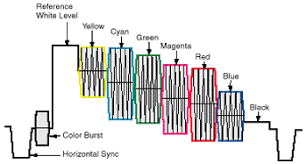

blue raven said:
namely the lack of black
Your worry is misplaced. The whole point of the CIE (chrominance)chart is that it is independent of the Luminance. I mentioned earlier that 'skin tones' are virtually identical for pale skinned Nordics and very dark skinned Africans. The RGB signals have more or less the same ratios for both skins. You can have a lot of fun with a colour picker, writing down the RGB values for various faces in a crowd.
If you look at the old PAL / NTSC coding you see the levels of luminance , varying over each tv line andthe phase carrying a high frequency chrominance subcarrier signal which varies in amplitude (saturation) and
'hue (the phase of the subcarrier). This colour bar signal uses very saturated bars.

sophiecentaur said:
Synthesis: It's easy to vary the R primary signal to the display without changing the G and B primary voltages and you would get a result that lies along a line between the white point and one side of the triangle.
Analysis: It would be very difficult to change the pigment / paint / filter to change just one of the tristimulus values.
'hue (the phase of the subcarrier). This colour bar signal uses very saturated bars.View attachment 355873View attachment 355874
And have you wondered how accurate these colors were reproduced on the screen? Back in time, it was common knowledge that screens didn't accurately reproduce colors to match a quality print. There was quite a difference between the image on the screen and the print.
Any change at the input must be measured at the output, using a device such as a spectrophotometer like this one, X-rite i1 or cheaper ones. Nowadays, good monitors can be calibrated in the range of an acceptable error Delta E, where this error is given by the deviations from the target color on the color map/space, see what Delta E is. A calibrated monitor comes with a report that shows the values of this Delta E error for each color, if I remember correctly. So the challenge is to keep all errors below Delta E<1.5, this error is good, in this case you can be sure that all colors displayed on the screen will match a quality print, which also can be verified using a spectrophotometer.
1.5 is huge EDIT: Big
