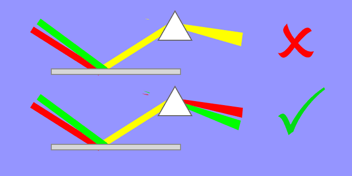

DaveC426913 said:
This diagram is good - as far as it goes. The result of adding monochromatic light (i.e. spectral) will never be a yellow of 600nm because your eye will not identify it as exact spectral yellow. The perceived resulting yellow will not be on the spectral locus on the CIEE diagram. It will lie on a straight line between spectral red and green. Your brain analysis will detect a hint of blue to de-saturate the yellow.
We can blame the very first exposure we all get about colour mixing which is over-simplified and confuses colour and wavelength in a very authoritative (the teacher told me) way.
The yellow ray in the diagram only 'looks' yellow. It's the most convincing of such demonstrations, of course and it only works because our kivinv experience very seldom exposes us to actual spectral colours. In the diagram I found, the result of mixing 450nm with 545nm will lie on a line nowhere near the spectral locus and be a very washed out 'cyan'. But, as I pointed out earlier, we just don't need good resolution of all those colours in the top left of the diagram so that's why it turns out the way it does. In a million years, there may be a good reason for us to need colour resolution in that space so we could develop a fourth colour analysis (and a modified TV system) to take care of that. The almost straight locus from 540nm to 620nm gives us a powerful ability to assess 'skin tones' so we can detect facial changes in mood and also the browns and greens that we need to assess the state of vegetation when we're hunting and gathering. Browns are essentially low luminance orange tones.
Yes, that is the entire message of the diagram.
Things that look yellow are yellow. Until and unless we have a way of examining their constituents individually (such as a prism).
(I was going to add 'or a digital camera' but a digital camera fails the same way our eyes do. Even if we caned the setup so that we shone a true spectral 575nm yellow on paper, the camera would only be able to pick that up by artificially breaking it into red and green components - corrupting the original signal.)
Followup question: Are there any devices other than a prism that can distinguish the true spectral nature of a beam of light? Many spectrometers use (or at least used to use) prisms. I suppose modern, solid state spectrometers don't, do they?
Totally agree.
Funny thing is that the one and only example 'they' quote of R+R=Y compares what you 'see' with a spectral doublet.

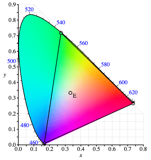

Edit: and I still need to learn how to read the CIE chart. The sodium doublet at 589.0 and 589.6 nm should show up as yellow, but the chart seems to suggest it may be red. I find the chart a little confusing...
and a follow-on: The part I was missing with the CIE graph is that the blue cone response z=1-x-y, certainly not self-explanatory, but I found it in a google. Meanwhile the red cone is x which also has some response from light around 480 nm=something that I pretty much knew from instinct, (i.e. violet and red are similar in appearance), and the y is the green cone.
I think that some of the coloring in the diagrams above may only be approximate=589 nm (sodium doublet) should come in as yellow. (also see post 18 by @sophiecentaur =I think the coloring in the diagram is incorrect=you do not get R+R=Y).
and if my arithmetic and graphing is correct, it looks to me like neither the composite of 550 nm and 650 nm nor the pure 600 nm yellow will have very much blue in it.

One additional comment on the above: If I have it right, on the CIE diagram ## x+y+z=1 ##. This makes it so the diagram, even though in 3-D space, is simply a plane in 3 dimensions. It is not a 3-D structure, so it is often shown as an x-y graph.
Given the x and y coordinate, (the red and green response), you simply do a little arithmetic to calculate the z=blue (normalized) response, where ## z= 1-x-y ##. The tongue shaped figure, with its colors painted in, actually lies in the plane ## x+y+z=1 ##, rather than in the x-y plane.
The next part, which I think I also have figured out now, is if you have one color of amount ## a ## at ## (x_1, y_1, z_1) ## and amount ## b ## at ## (x_2,y_2, z_2) ##, then the resultant color (coordinate) is the normalized ## (x_3,y_3,z_3) ## that you get by doing a vector addition ## \vec{r_3}= a \vec{r_1} + b \vec{r_2} ## and normalizing ## \vec{r_3} ##.
Edit: One slight addition/correction to this is that this normalized vector can be used to define a line ## \vec{r}=\vec{r_{3n}} t ##. The color coordinate is then found by where this line intersects the plane ## x+y+z= 1##. I think I have this last part correct now, but I am on a learning curve with the CIE map, so I welcome any feedback.
With my latest entry in post 23, I think I have it correct now. This seems to make sense since if two colors with different coordinates are added together in varying amounts, the result in the 3-D space will be that the two coordinates will make for two vectors of varying lengths (added together) that define a plane. Where this plane intersects the plane ## x+y+z=1 ## will be a line on the CIE map that yields all the possible results, (i.e. colors), from the two sources.
I welcome any feedback. This topic (the CIE map) is written up in a couple places in the literature, but I think I have been able to pick out a couple important features that aren't emphasized very much in the write-ups.
Edit: One other item is that they could have defined the x-y-z color coordinates by the direction of the normalized unit vector in the 3-D space, but instead they used a slightly different scheme where the color coordinates are found by the location where the line in the direction of the unit vector intersects the plane ## x+y+z=1 ##, (instead of using the point where the line intersects the unit sphere ## x^2+y^2+z^2=1 ##).
One other detail is if we say we have amount ## a ## at one color coordinate and amount ## b ## at another, how do we know what to reference the ## a ## and ## b ## to ? It appears from what I read in the literature that they use/specify the amount of the y components to get the multiplication factors ## a ## and ## b ##.
If you look half way along the R-G line, the colour is a fairly convincing yellow to me. If you are looking for an error (not a bad idea, aamof) then I guess there may be discrepancy from source to source - although all the versions of CIE charts on a Goodle search seem to agree largely. If you look in a variety of printed versions, I'd bet there would be a significant spread.
You make a very valid comment that Yellow on the chart is not actually a spectral sodium yellow. I imagine that example of colour matching would have been chosen because it was easy to give a convincing demo, with a sodium source and a couple of very loosely specified primary filters in front of filament lamps.
During the development of colour TV, there have been several specs for RG and B phosphors but the human colour vision system takes care of that, as long as the synthesis formulae are adjusted for each system. The only colours that can be displayed lie within the gamut of the RGB triangle. The result is that very saturated colours cluster on the sides of the triangle. I have noticed that sports crowd scenes often seem to show the same colours of bright outdoor wear. I think that must be due to this ('crushing') effect. Systems have developed to show a bigger range than in the past. Modern TV displays are seriously stunning, compared with early CRT displays with inadequate phosphors.
sophiecentaur said:
A point of information: RGB are essentially used to describe the Synthesis of colours in a display. The spectra of the 'phosphors ' and the points on the CIE chart are not the same things. The RGB 'points' do not actually represent monochromatic sources because the requirement is for bright sources and different display technologies may well use different spectra to achieve the same RGB points. The eye / camera analysis curves are not the same as the spectra of phosphors; they are essentially very broad band. They have to be, in order to catch all wavelengths and they all overlap. Note the SML labels and not RGB. There is some complicated processing to get from those three signals to appropriate signals to drive the phosphors with.
OMG is it verboten now? I wonder why. I imagined it was a fishing term?
The region at 570 nm is yellow to me, but at 590 nm it is already very orange. It is possible though that my computer screen does not have the same colors that yours does. In any case, by 600 nm (from the chart from your post 16) I see it to be very orange and almost red.
Edit: It is possible that my OP is in some error, and that 600 nm is actually orange, and that I should have used 570 nm for yellow. I did not base my OP on the CIE chart, but rather on knowing that the sodium doublet at 590 nm is yellow. Perhaps I made a slight error=not sure at this point. [and a google shows yellow to occur in another chart from about 580 nm to 590 nm. The transition to orange is very rapid and happens by 600 nm. Meanwhile 570 nm in this other chart still looks rather green]. See https://www.lumitex.com/blog/visible-light-spectrum
See https://www.physicsforums.com/threads/color-theory-what-does-blue-yellow-make.1008903/
The exam question presented in this post also calls 600 nm as yellow=perhaps it is also in error.
Meanwhile your inputs and feedback are very good=thank you. :)
