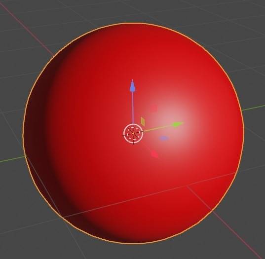

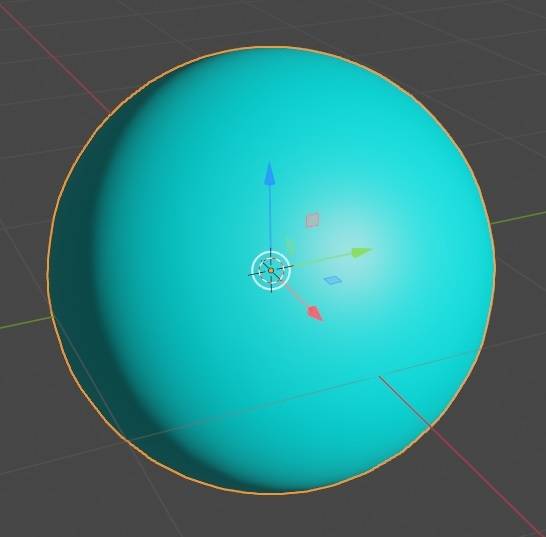

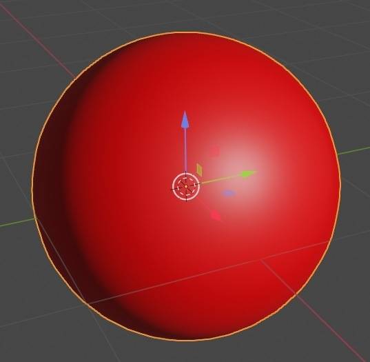

Here is are examples of a primary (red) and secondary (cyan) colors, which if sampled anywhere on their surfaces will return hue 0 for red and 180 for cyan as expected:

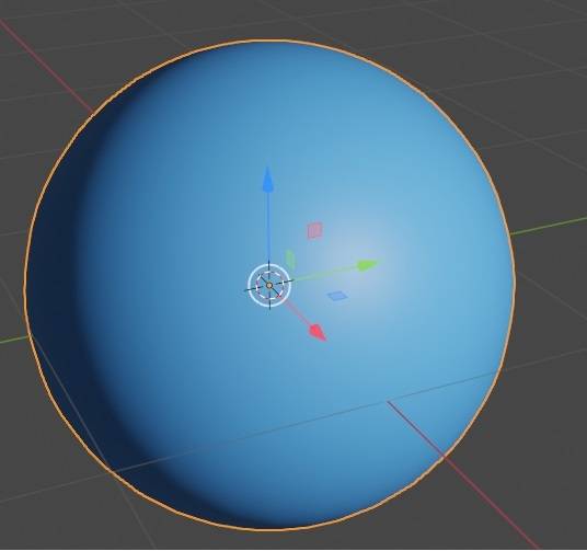

Here by contrast is an intermediate color between blue and cyan, where we can see that the highlights measure around 202 degrees (towards cyan) and dark regions 211 degrees (towards blue):

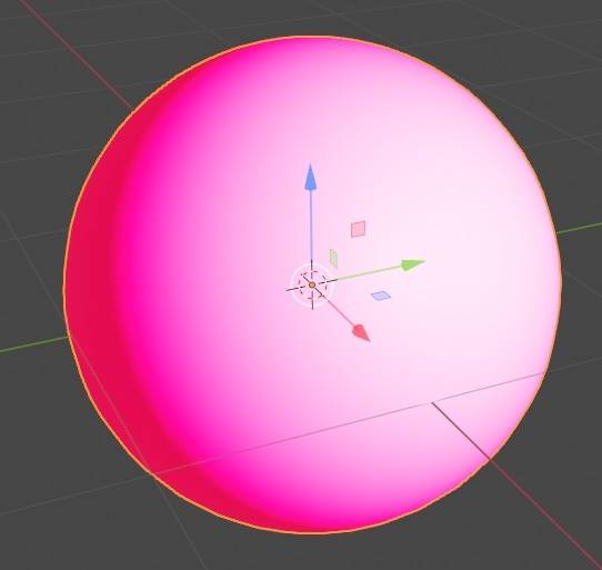

Here is a more intentionally dramatic case where we can see the sphere can measure up to 315 at the highlights (towards magenta) and 341 in the dark zone (toward red), thus giving a 26 degree hue rotation just by power of variable illumination:

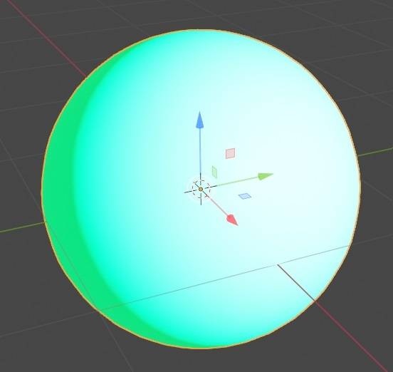

Or here we see and measure the sphere clearly tilt cyan at the highlights and towards green at lowlights when the color is between these primary/secondary points:

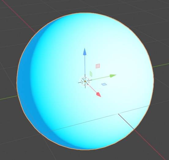

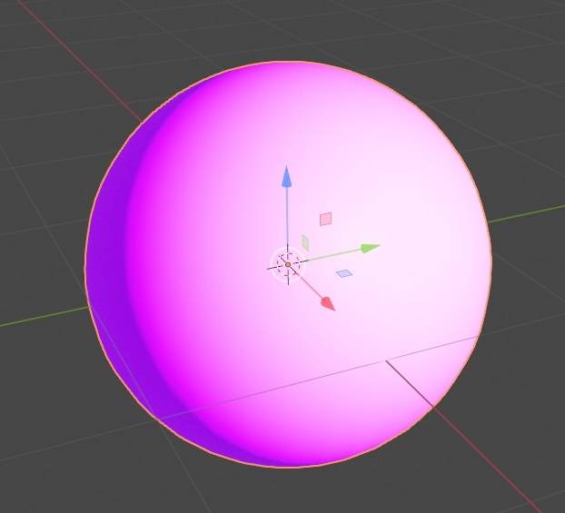

Or others here tilting from cyan to blue in dark or magenta to blue in dark:
These objects are being lit with pure white light in simulation. I am wondering if anyone is familiar with the nature of this phenomenon or if there are any existing mathematical models that describe it. ie. Models that can predict how the measured hue of a given colored object will shift from its actual color to the nearest primary color as illumination intensity or its value is decreased.
