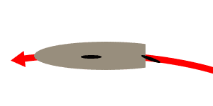

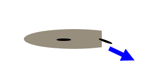

But during 2 to 3, rudder produce drag and when stops in position 3 produce thrust?
  • #45

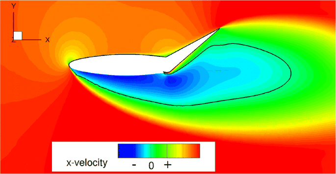

Maybe 2D analysis is insufficient. A 3D analysis would throw water outwards and backwards when the rudder is moved, with the water being replaced from below the rudder post. That is a part turn of a centrifugal pump. The reaction to moving water along that path is forward.

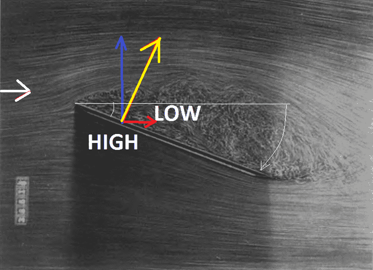

I use nylon as rudder, to see where is high and low pressure side during rotation.
We can see in which side is nylon angled during 2 to 3 position,high pressure is at the front and low at the back,that mean resultant force is point backawards, prependicular to rudder surface(in case of stiff rudder)
It seems when rudder stops at postion 3, nylon angled to the front, that mean pressure field is reversed,so high is back low is at front,so resultant force switch to forward.
But time from 2 to 3 is longer than just this "second" when rudder stops at 3, so I think net resultant force from 2 to 3 is backwards. But who knows, maybe is resultant force at position 3 enough greater in magnitute than from 2 to 3 so net force is forward...
Interest to me is that almost all water that goes backward is done by low pressure side, it is very hard to see any backward movement of water at rudder high pressure side, indeed lots of water near the front edge of rudder(pivot point) goes forward and "leak" to low pressure side!
Obviulsy centifugal force is here too weak for low speed rudder swings to win against pressure differential.
Water is "pulled" backward by low pressure side not "pushed" by high pressure side,like was my first intuition.
Slow down speed and increase resolution to see better what is going on.

I think it is very complex to calculate this, when boat start moving we have induce flow which increase pressure at low pressure side when rudder rotate from 1 to 2 and increase pressure at high pressure side when rudder rotate from 2 to 3.
Also rudder accelarate and decelerate, which aditionaly complicates calculation.

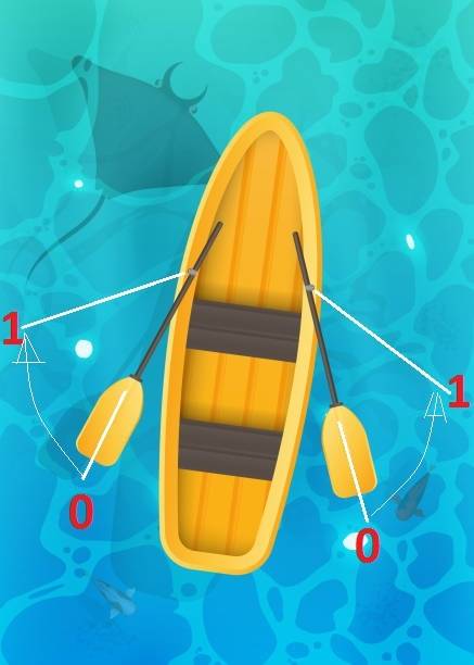

If you move paddles from position 0 to 1, boat will start go backward,not forward.
  • #57
But you still have not clarified what you mean by "the pressure field is reversed".
I am not sure what point you are trying to make.

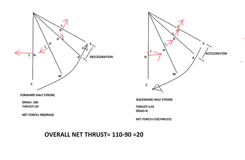

My main question is " does forward rudder stroke (when rudder moves from position 2 towards 3 or 2 towards 1 ) produce thrust or reverse-thrust?
Yes when rudder make backward stroke( 1 towards 2 or 3 towards 2) high pressure is at back and low pressure is at the front side of rudder.
When rudder make forward stroke(moves from position 2 towards 3 or 2 towards 1 ) high pressure is at front and low pressure is at the back side of rudder.
So I tell pressure field is reversed during forward and backwards strokes in relation to boat forward direction.
  • #59
It does not produce forward thrust. It will produce drag which is a force opposite to the direction of motion relative to the overall direction of motion of the water. The amount of drag will vary from insignificant to quite a lot depending on a number of variables; you appear to want to call this drag "reverse thrust" but this would not be a term I would use within the normal range of these variables.
