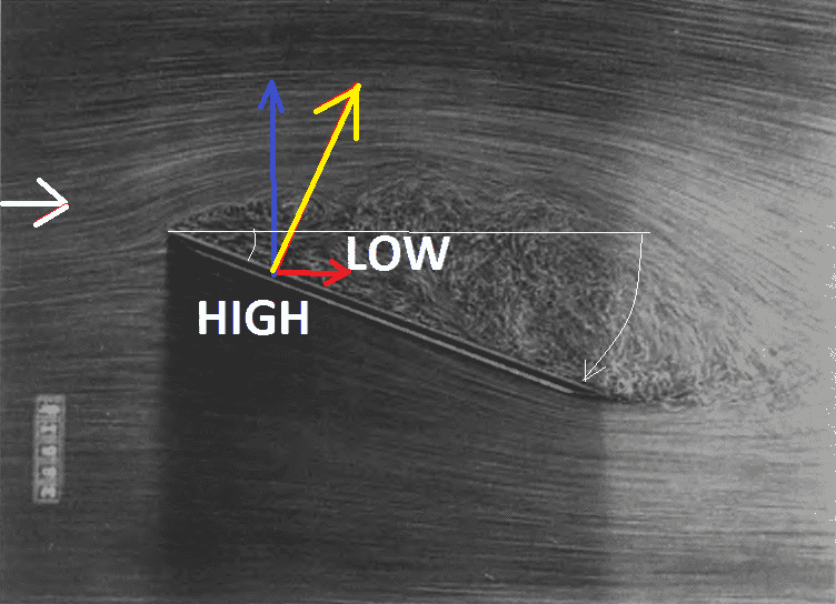

What is difference, any movement of rudder from centerline position will cause high pressure at the front side of rudder, reslutant force has side and drag component,which slow down the boat/aircraft.
Dont agree?

This may be a source of confusion. While there are similar components, this scenario is not comparable to an airplane.
As we just established, a boat can certainly experience an amount of yaw when being sculled via rudder. That's not comparable to a plane (which would nosedive).
Thus, a rudder deflection does not necessarily only induce drag - as one might think if one assumes movement has to be straight along the centre line.
Also, the propulsion does not necessarily have to be along the centre line of the boat to have its gross movement be straight(ish). That's what the keel is there to do. (There's no real aerodynamic equivalent of a keel).
We should drop the comparison to an airplane.

Air has mass too. It is not just velocity that matters. Acceleration enters in. It would be nice to see you acknowledge this fact.
At the end of a stroke (of sail or of rudder) as the foil is brought to a halt, I would expect the pressure gradient to change directions due to the resulting fluid acceleration.
So I neither agree nor disagree. I claim that the question has not been asked with sufficient precision.

Also, define "front side of the rudder" without assuming "front" is the nose of the boat.
See the white arrow on the left? That may apply to an airplane, but it is not fixed for a boat that's yawing left and right.
(refer back to post 80)

But the devil is in the details. The diagram you posted in post 79 treats front as exactly - and always exactly - frontward. With a turning boat and a thrust that is not along the centre line, the posted diagram is just not informative.
I reassert that you should not make comparisons to aerodynamic scenarios.
