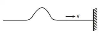

When I see the word pulse, it brings to my mind a pulse traveling in a rope as shown in diagram below and I cannot relate dispersion to the rope medium in which pulse is travelling. What I do know is that white light gets dispersed as it passes through another medium like glass due to different refractive index for each color in the incident white light resulting in different angles of refraction in glass for different colors of light. But I cannot see any distortion occurring in incident sinusoidal light wave since the refracted light for each color is also a sinusoidal wave. Diagram of a single bump-shaped pulse on a horizontal string moving to the right toward a fixed wall, with an arrow labeled v above it showing the direction of travel.
  1. Can I have a pulse of light or pulse of sound? Probably not. I can relate a wave to sound or light as in a sinusoidal wave.
  2. Even though light is getting dispersed in glass, how is the light wave getting distorted? The light wave for each color in glass is still a sinusoidal wave and I cannot see where the distortion is.
  3. Does the word pulse in this question mean a sinusoidal wave? To me, pulse means what is shown in the diagram above.
  4. Can there be dispersion of a pulse in a rope? Probably not, since the pulse keeps traveling in a rope unchanged until it hits a fixed/free boundary where reflection occurs. If the boundary was a free boundary, then a part of the pulse gets reflected and a part gets transmitted with a lesser amplitude.

4. Yes and no. At the most basic description, the wave velocity in the rope depends only on the rope's tension and linear density (and not wave frequency), which means all frequencies travel at the same speed. Because of this, there is no dispersion. If you go to higher order descriptions, there may be sub-leading effects that result in dispersion, but at leading order the pulse will retain its shape.
If the rope is not uniform in its mass density, then the same pulse will change its velocity as it travels through the rope. But then how will the pulse disperse in rope?
If the rope does not have a uniform mass density this will introduce non-linearities. The wave equation will no longer have constant coefficients. You will introduce effects such as wave reflection where you have changes in velocity. This can become quite messy.

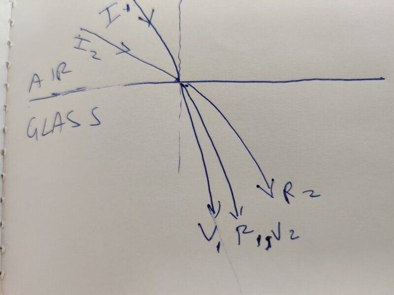

Why would separated colors interfere? My impression is that each color would have vibrations about different paths and so they would not interfere.
Or we need to consider multiple incident rays of white light at different angles, and then refraction of colors of these different incident white light rays could result in different colors traveling along the same path and therefore, having a superposition of color waves?
Handwritten ray diagram of light crossing a flat air-glass boundary, with incident rays I1 and I2 in air, reflected rays R1 and R2 going back up, and refracted rays V1 and V2 going down into glass.
haruspex said:
Will the sum of such separated sinusoids still be sinusoidal?
No, if the different color waves follow the same path in refractive medium since being on same path means they will superimpose and also they will have a certain non-zero path difference or phase difference due to different velocities in glass. The second diagram show red light and violet light in glass that come from incident waves ##I_1## and ##I_2## respectively.
I think you are confusing two concepts. We are not concerned with phase difference in light as a wave.
A pulse of light can not only consist of many frequencies but also be many wavelengths long of each frequency. A shift in phase of some frequencies relative to others might not be evident, but if one frequency travels fast than another the entire train of waves of that frequency will arrive earlier.

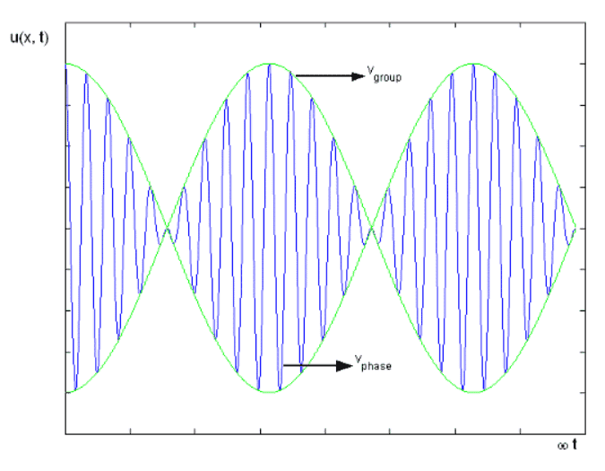

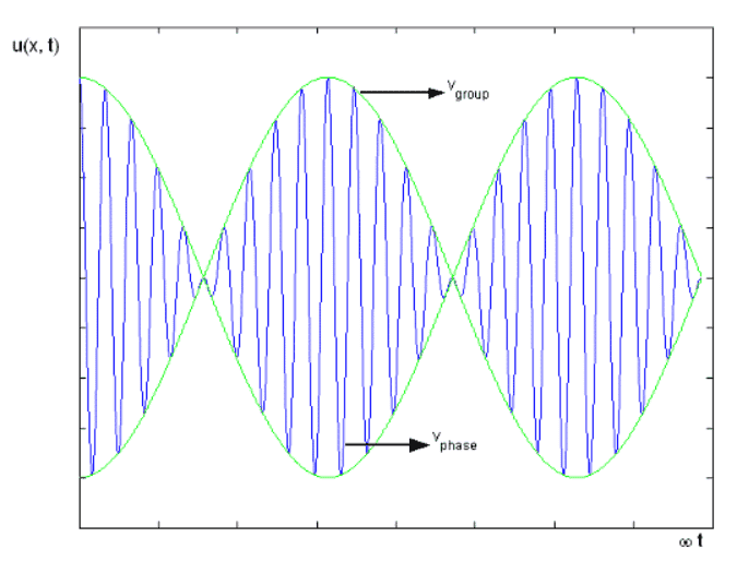

Below is a diagram that is the resultant wave of superposition of two different frequencies. We see a symmetrical green line i.e. symmetrical envelope.
Plot of u(x, t) against x t showing a blue high-frequency oscillation inside a green symmetrical envelope, with arrows labelled v_group and v_phase indicating the envelope and carrier wave motion.
At the link I mentioned, it talks about dispersion in the context of above diagram.
If the derivative term is zero, group velocity equals phase velocity. In this case, there is no dispersion. Dispersion is when the distinct phase velocities of the components of the envelope cause the wave packet to "spread out" over time. The components of the wave packet (or envelope) move apart to the degree where they no longer combine to complete the envelope.
The wave packet seems to be what's within a peak or crest of the green line. When velocities of component waves/pulses change from the values that produced the envelope (i.e. green line) then the superposition of new waves/pulses changes the envelope i.e. green line. The envelope could now become asymmetrical and there is no proper identification of a wave packet. Is this what you meant, when you said "Will the sum of such separated sinusoids still be sinusoidal?"?

Yes. In the diagram above, a pulse is one rise and fall of amplitude, i.e. the upper green line between two zeroes. It could be any single-peaked shape.
If a pulse is the sum of such with different frequencies then dispersion will cause them to separate, changing the shape of the pulse as a whole.
