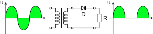

An iron object held near an electromagnet will vibrate if the field from the electromagnet is varying.
This will not occur if the electromagnet is getting steady DC as from a battery but it will happen if the electromagnet is getting pulsing DC, or AC.
It will get pulsing DC if the output is taken directly from a rectifier without any filtering.
Like this:
You can see how the voltage is varying in both the AC input and the pulsing DC output and either of these will result in a varying magnetic field if applied to an electromagnet, so you would get vibration.

Yes, you would have to run the electromagnet from pure DC, not pulsing DC.
If the electromagnet would work on 12 volts, you could just connect it to a car battery.
Or, you may be able to smooth the power supply by adding an electrolytic capacitor across the electromagnet.
These have to be connected the right way around (+ve marking to the +ve supply) and the actual capacitor would have to be chosen to suit the electromagnet.

An electromagnet will behave the same as a magnet only when you power the electromagnet from a true DC source, such as a battery. If it is powered from a simple home-made DC power supply, then you're apparently getting some "ripple" current into the electromagnet - a portion of the AC waveform is still present at the output of the power supply. This time-varying current is what is causing the time-varying magnetic field that you feel. Adding a very large capacitor to the output of the power supply will reduce, but not eliminate, the ripple. A high quality electronically-regulated power supply can come much closer to an ideal DC source, but a battery is simpler and cheaper.

Do you have a voltmeter? Check the voltage from the power supply.
It is possible that that power supply is delivering more than 12 volts average because there is not much current flowing.
If it is giving an average of, say, 15 volts, the peak value of the pulses coming out of it will be about 21 volts. If you put a capacitor across the output, the voltage will rise to around 21 volts as well as being smoother.
This will certainly make your electromagnet more powerful. The current in it will rise to about 0.5 amps.
Check that it doesn't get too hot. It will be dissipating about 11 watts, which could make it get quite hot.
The capacitor should be in the range of 1000 uF to 4700 uF and rated for 40 volts.
