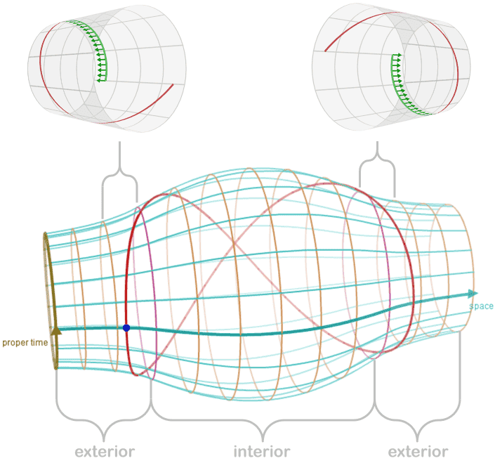

It follows a geodesic in space-time, which has distorted coordinates:
Grasshopper said:
How would a reference frame above the Earth, watching two apples approach the Earth from opposite ends of the planet, describe the events?
On the global scale spacetime is intrinsically curved (as shown below). It cannot be rolled out like the cone in the video above, which approximates just a small radial range:
The red path is the geodesic world-line of a free falling object, that oscillates through a tunnel through a spherical mass. Note that the geodesic always deviates towards the "more stretched" proper time, or towards greater gravitational time dilation. Gravitational time dilation has an extreme point at the center of the mass (gradient is zero), so there is no gravity there (but the maximal gravitational time dilation).
