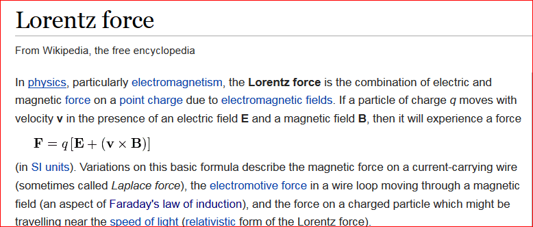

marciokoko said:
Btw, when the voltage is supplied, it is propagated at the speed of light?
it is easy to get incorrect mental models in one's head
i want to say 'yes' to your question even though a more typical number is 2/3c. Electrical properties of whatever the field is traveling through get into the picture,
but do not think the charge carriers(be they electrons or ionized molecules) move anywhere near so fast
Screenshot of the Wikipedia article 'Lorentz force' showing the definition text and the formula F = q[E + (v x B)].
