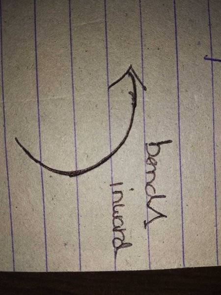

I feel that the slipping is inward because the car seems to move on a circular track which continuously bends inward.

I feel that the slipping is inward because the car seems to move on a circular track which continuously bends inward.View attachment 228686
That's turning, not slipping. Slipping is what the car does if the wheels don't have friction and the car doesn't turn. E.G., when you turn the wheels on ice and the car keeps going straight. If the car moves away from the direction it is supposed to be turning, that is "outward".
