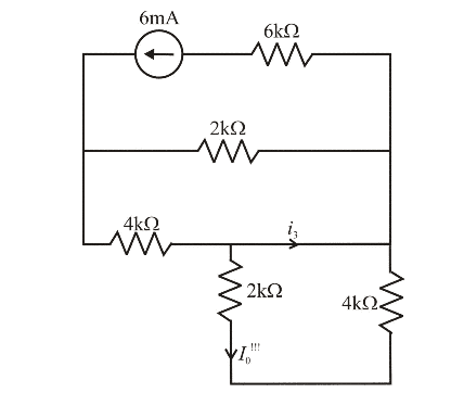

hi, please have a look of the following picture.http://www.cramster.com/solution/solution/1175199
Do you guys get 0 for io'', why is it 0?
Because the potential difference between the points to the left and the right of the i_3 arrow is 0, because there's a wire between them with 0 resistance.
I = V * R and R is 0, so V = 0.
Yes, I0=0, because the path of i3 is a short circuit. But Ohm's law is V=I*R (not I = V * R). This yields V=i3*R, and since R=0, then V=0, regardless of i3.
(V = potential difference between the points to the left and the right of i3,
R = resistance between the points to the left and the right of i3)
A more formal explanation: Kirchhoff's voltage law (KVL) says "The directed sum of the electrical potential differences (voltage) around any closed circuit is zero." In the picture the path of i3 and I0 is a closed circuit. Since V=0, this means the voltage Vlower across the two lower resistors must be 0, which yields I0 = Vlower/(R1+R2) = 0 V/6 kΩ = 0.

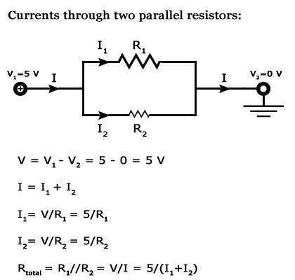

Consider doing a quick re-draw of a circuit if it's not clear what's happening at first, this way you can see what's happening with the currents:
http://img560.imageshack.us/img560/1792/dsc0005ew.jpg
I'm with Sophiecentaur and NewtonianAlch here. Sophie did a good thing by correcting a common misconception (that current always takes the shortest route is wrong), and also provided a short, excellent and correct description of how currents are divided between paths. No, in reality there are no connections with zero resistance (the closest thing would be superconductors, but today they're still a little difficult to implement for common use :smile:).
I wish you all a good weekend!
(Current paths update)
Image description: R1 is a large resistance, R2 is a small resistance (e.g. from a wire or inductor). We can see that a smaller resistance R2 will result in a larger current I2. I1=V/R1, so I1 can in reality only get truly zero if the voltage V across R1 is truly zero.
Note: Rtotal=R1//R2 means R1 parallel with R2; a smaller R2 will result in a smaller Rtotal. (if anyone spots a typo, please say so, I'm a little tired at the moment :smile:)
And here's a link for Resistors in Parallel (see Example No3 in particular):
http://www.electronics-tutorials.ws/resistor/res_4.html
