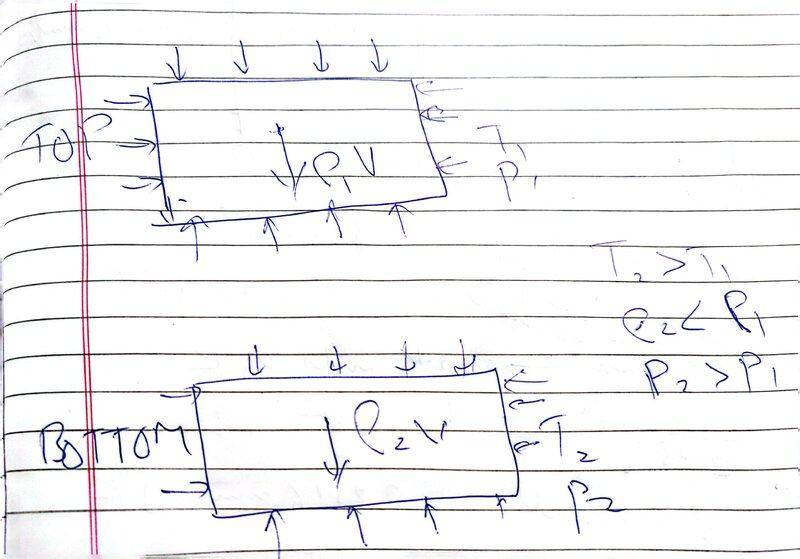

I am trying to explain a common phenomenon in nature. The phenomenon is that warm air in room rises in a room and colder air at the top of the room settles down closer to the floor of the room.
##\rho = \frac {m} {v}##, where ##\rho## is density of material and ##m## , ##v## are mass and volume of a certain amount of the material
My answer given below seems incomplete.
Since warm air causes the air to expand in volume, so its density becomes less as compared to the colder air at the top of the room. After this, I generally find all books saying the less dense air rises and more dense air from top comes down and therefore this phenomenon occurs in nature.
But, how would I explain why less dense air rises and more dense air falls. I have tried to explain it using the diagram below which shows two cubes of air at the top and bottom of the room. The arrows for each cube indicate the pressure acting on the cube from all directions. Wouldn't the force due to pressure on each face of the cube be balanced by the force due to pressure on the opposite face of the cube? If yes, then I cannot explain why the cube of air at the bottom would rise since it needs to have a net upward force acting on it in order for it to rise. If the upward pressure is greater than the downward pressure on the bottom cube, then I could say that the less dense cube of air will rise since it would end up having a net upward force.
Or perhaps, there is another explanation for this.
For the sides, yes. For the top and bottom, no. Remember that the fluid (air or liquid) near the bottom of the box is holding up more stuff against gravity than the fluid near the top of the box. This means there is a greater pressure on that part of the fluid, which is exerted against the bottom of the box, lifting it up.
In other words, the pressure at the bottom of the box is greater than at the top, leading to a net upward force against the box.
Can we say the following?
The pressure on the top face of bottom cube is greater than pressure at the bottom face of the same cube because the temperature decreases as we go up and for a gas ##P \propto T## (at constant volume), so we can say that top face has a lower temperature and therefore lower pressure.

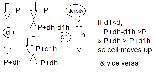

Not sure I understand what is being said, so I drew a diagram (as always for me!)
Now, I'm as troubled as you (or whoever) that when there is no solid box, there can't be two different pressures in the same place. So I guess that as soon as there is the smallest difference in density, something starts moving and we can add terms like F=ma to bring the pressures at the interface back in line.
If the packet of air ascends at a steady speed, I'm still struggling with that one.

vcsharp2003 said:
Normally, we apply this principle only when a solid is partially or fully submerged in a fluid.
You are treating the parcel of air as a body, and the surrounding air is a fluid.
I do not understand your diagram. The pressures inside the box differ by 2d1h-dh. Shouldn’t that be just d1h?
