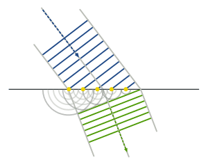

Remember that rays are only an approximation to real light, which is a wave. The light refracts towards the normal upon entering a medium with a higher refractive index because it travels slower inside the medium. See the image below. (Blue and Green arrows are the light ray)
Notice how the wavelength of the incoming light wave (blue lines) is larger than the wave inside the medium (green lines). This is because the speed of the wave is slower inside the medium than outside, while the frequency remains the same. The part of the wavefront first entering the medium is slowed down, allowing the parts yet to enter the medium to 'catch up' to it. When these later parts enter the medium they interfere with the part already there, and the interference of the different parts of the wavefront results in a change in the direction of the wavefront towards normal.
