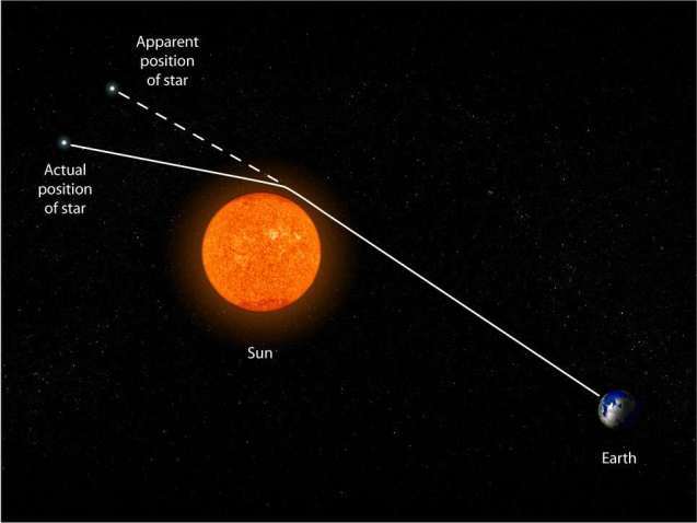

gravitational lensing small scale of starlight around our sun ...
Diagram of gravitational lensing of starlight by the Sun: a solid line from a star's actual position bends past the Sun to Earth, while a dashed line shows the apparent position of the star, offset from its actual position.
