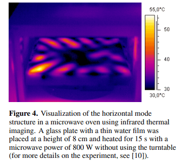

My - to some extent random - bet would be on the shape of the microwave working box (whatever it is called).
Microwaves used in mw ovens have length comparable with the oven box. That means plenty of interference and reflections, possible standing waves and whatnot. That in turn means there are places inside that heat much faster, and places that heat much slower. Turntable moves your food to average the heating, but it can be still not enough and there can be still some hotspots.
So yes, what you observe is counterintuitive, but probably can be explained by the energy density distribution inside (which is far from uniform).

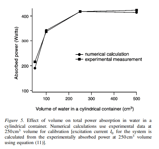

Possibly could be related. We usually assume that 100% of the power coming out of the magnetron ends up in the food minus some losses in reflections, etc. It is not impossible though that some of that power is actually dissipated elsewhere in the oven. So maybe if you put two cans of soup in at the same time which would put a larger load in the oven maybe the two would behave more similarly while accounting for differences in power? It's a place to start. Maybe a cup of water in along side the can of soup would show something. This is essentially matching the load better to the source.
You say that all of the power ends up in the food, but doesn't it depend on the size of the load (a single chicken thigh vs. a whole roasted turkey), composition (percent liquid content, thawed vs. frozen) and other factors?
Try putting a half cup of water in the microwave for a minute. Now do the same with a quart. The half cup will become much warmer.
Of course. The quart has a much higher heat capacity. The small container can still have smaller absorption--or not, depending on the locations of hot and cold spots created by standing waves, etc. Standing wave patterns are striking Vollmer [2004]
Here are a simulation and measurement of the volume effect:
The paper shows a complicated dependence on many factors. Zhang [2003]
So based on post #17, what I said is correct. The power generated by the magnetron is not necessarily all absorbed in the food. I said it was often assumed to absorb it all. I also said:

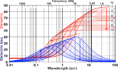

I think it's the other way round. The frequency is chosen to match the absorption bands of the food (water / fat? ) and the cavity dimensions should be chosen to get a suitable set of mode patterns. The food can affect the pattern, especially if it's absorbing well. Then there will be 'design features' to fit a cavity into the box. If the oven is conveniently small for mobile use then the cavity may not be ideal.
The OP could try putting the chilli in a different shaped container (say shallow bowl) to see if things change. But then there's the washing up to deal with . . . .
Averagesupernova said:
Do not put words in my mouth.
Just put the chilli! Har har.
Actually, water has an extremely broad absorption spectrum. Rather than exciting a particular resonance, heating occurs through dielectric loss. See the blue curves below.
[Wikipedia]
The frequency at which microwave ovens work, shown by the bold vertical line, is not near a peak, indicating that efficiency could be improved by going up in frequency.
2.45 GHz is chosen because it lies in the FCC's unregulated ISM band (industrial, scientific and medical). Devices there are allowed to operate without requiring an individual transmit license, although there is a strict limit on radiated and/or leakage power. (Imagine if every microwave oven required its own license, like KCBS!) Other common uses for the ISM band are WiFi and Bluetooth devices.
EDIT: I should add that the ISM band has been dedicated for these uses throughout the world by international treaties, not just by the FCC in the USA. Microwave ovens work at the same frequency everywhere.
Depth of penetration is reduced at the efficient 20GHz frequency for 20 degree C water. At the 2.45 GHz, the waves heat farther into the material than just the surface, which is probably a good thing for cooking of food.
https://water.lsbu.ac.uk/water/microwave_water.html

Microwave ovens aren't really all that great at heating things evenly, at least in my experience. I don't know how many messes I've had to clean up. The fact that one manages the task and another messes it up is hardly a surprise.

There may be another issue of where and how the microwaves are fed into the cavity. I would imagine that the design of a budget device might not be optimal for all foods / containers / masses. I can feel an experiment coming on.
