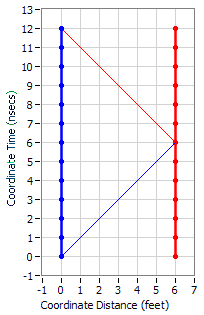

I think spacetime diagrams are very helpful in explaining and understanding Einstein's theory of Special Relativity. The first one shows an observer depicted by the thick blue line looking at his reflection in a mirror that is six feet away from him. He and the mirror are stationary in this diagram. The dots mark off 1-nanosecond increments of time. The thin blue line depicts some light that travels from his face to the mirror and the thin red line depicts the reflected light coming back. Note that the speed of light is 1 foot per nsec and always appears as a 45-degree diagonal line:
I hope this makes perfect sense to you.

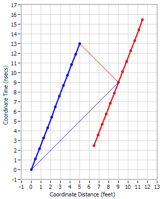

Now I'm going to show what this same scenario looks like when the train is going faster and faster. The first speed is 38.4615 percent of the speed of light. I use the Lorentz Transformation process to do this:
As you can see, the distance to the mirror is now about 5.5 feet, compressed, as you say, from 6 feet. And the observer's clock is going slower. It takes 13 nsec of Coordinate Time for it to tick off 12 nsec. But most importantly to your issue is the fact that the light is still traveling at 1 foot per nsec along the 45-degree diagonals but instead of taking 6 nsecs to get to the mirror and another 6 nsecs to get back, it takes 9 nsecs to get to the mirror and 4 nsecs to get back. But it gets back just at the moment the observer's clock ticked 12 so as far as he can tell, everything is the same as when he was stationary.

I think it is clear that the closer the train gets to the speed of light, the longer the light takes to get to the mirror but shorter it takes to get back but never does the light have to propagate at any speed other than 1 foot per nsec.I hope these diagrams make it perfectly clear what is going on but if not, just ask.
thank you this was very helpful.
