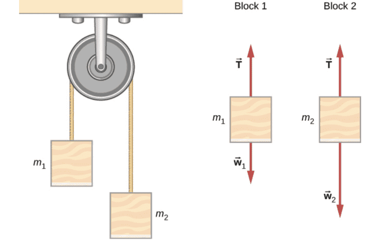

Why doesn't the released mass m2 on pulley have higher acceleration since it is no longer subject to the upward force of tension?
Consider the pulley in the attached image to be frictionless. (a) If m2 is released, what will its acceleration be?
My question is why wouldn't m2's acceleration be greater if released rather than attached to the string because m2 released is no longer subject to the string's upward force tension?
  • Diagram of an Atwood machine: masses m1 and m2 hang on either side of a frictionless pulley, with free-body diagrams for Block 1 and Block 2 showing tension T up and weight w1 or w2 down.

Is there an actual full problem statement associated with this image? Of course if you cut the string, M2 will free fall. But are they actually asking about when the 2 masses are still connected to the string? Then the acceleration will depend on the difference between the 2 masses, no?

Usually "released" means let go out of your hand. If they were cutting the string, the verb "cut" would likely be used. I suppose you could submit both answers for extra credit to your teacher... :wink:
"Consider the pulley in the attached image to be frictionless. (a) If m2 is released, what will its acceleration be?"
If the problem would mean to cut the string, how important the friction in the pulley would be?
As @berkeman stated above, somebody has been holding mass 2, preventing the system from moving under its own forces.

a) If m2 were cut, initially a2 = a (acceleration of mass on string) - g but then a2 grows to equal -g
Is that correct?

As I understand this new question, you previously have released mass ##m_2## from your hand. It is accelerating at some rate ##a## while mass ##m_1## is accelerating at the same rate in the opposite direction.
You ask about how the acceleration changes from ##a## to ##-g##.
If you snip the [ideal, inextensible] cord above mass ##m_2## instantly then the acceleration of ##m_2## will change instantly. It will not slowly "grow".

No. Use ##F=ma##. What forces are on ##m_2## after the string is cut? That's what determines the acceleration.

My previous post only tried to reason about the release of mass 2 (from a repose condition), rather than being allowed to free fall (detached from the string and the effect of mass 1).
If mass 2 is released, tension in the string increases to a maximum value, which reaches mass 1.
After that instant, mass 1-string-mass 2 become a system that moves (or not) at same rate of acceleration.
Such a system is also known as an Atwood machine.
Being frictionless, the pulley only job here is to change the direction of the string and its internal tension.

If the force changes discontinuously then so does the acceleration.
Edit: Yes, there are always (almost always?) limits on how rapidly forces can be changed. But they can be changed pretty rapidly.
