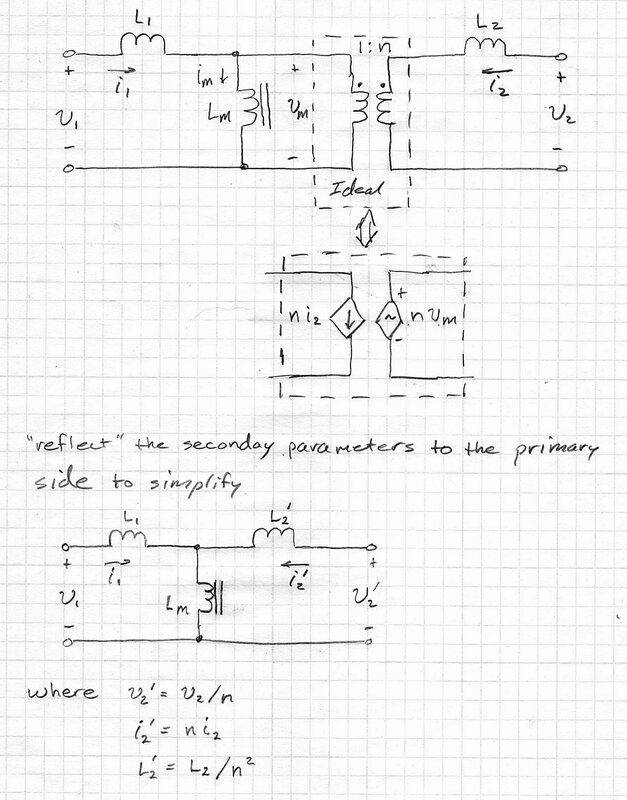

I think I see what @cmb is puzzled by, and that is basically the "magic" of the transformer, that it can adjust its primary current when the load increases, and the magnetic flux in the core basically stays the same, with the primary mmf ## N_p I_p ## balancing the secondary mmf ##N_s I_s ##.
With the "links" of post 40, the upper limit to the secondary and primary currents seems to be governed by how much current the copper wire can handle, rather than by any changes that may be happening in the iron core due to the increased loading.
Perhaps there is something that is present in the calculations, in addition to this, but with the balance ## |N_p I_p|=|N_s I_s |##, it seems that higher powers are readily accommodated by the transformer core, at least when ## k \approx 1 ##. I think this is what the OP has been asking several times throughout this thread. See also https://www.physicsforums.com/threads/magnetic-flux-is-the-same-if-we-apply-the-biot-savart.927681/ post 17, where Jim Hardy talks about this self-balancing. @cmb Perhaps you would find this entire thread good reading, where the operation of the transformer is discussed in detail.
Perhaps it would be useful to take the limit in the equations of post 43 for ## Z \rightarrow 0 ##, when ## k \neq 1##, but I haven't figured out the implications yet.

This is indeed a very interesting question.
First of all, of course, under ideal conditions, the magnetic flux inside the magnetic core will not change when the output current increases. Since the number of turns of primary winding and the number of turns of secondary winding of the transformer have not changed, if the magnetic flux changes, it means that the input and output voltages have changed, but this will not happen.
Since the magnetic flux inside the magnetic core will not change due to the increase of current, as long as the diameter of the winding wire is continuously increased to keep the ohmic loss constant, then we can continue to increase the power of the transformer while maintaining the size of the magnetic core. This is really great.
In theory, this idea seems to be feasible, but for engineers, as long as they think about it carefully, they will know that it is actually not feasible.
This is because, in addition to the limited winding window area of all types of magnetic cores that can be purchased on the market, when the wire diameter or the number of winding layers continue to increase, the leakage inductances will inevitably continue to increase, so the efficiency of the transformer will continue to decrease until it can no longer be used. At this time, the transformer will be equivalent to a transformer without a magnetic core.
Although in principle we can make a power transformer without a magnetic core, the size of the transformer will be large, the leakage of magnetic flux may cause a lot of interference, and it does not comply with economic and environmental principles. :smile:
I believe @Dale's excellent analysis shows this only to be absolutely true for perfectly coupled (k=1) transformers. The salient point in your analysis is still approximately correct: in fact it gets worse than you say because as the coupling degrades and the secondary load increases the core flux directly
Of course, the coupling factor must be equal to 1. If this condition is met, the core flux will not be affected by the load current, so I said that under ideal conditions (It may also include the condition that the winding resistance is zero, but there seems to be a contradiction. If the winding resistance is zero, all problems have been resolved). :smile:
When leakage inductance appears, the coupling factor will decrease with the increase of leakage inductance, that is, the coupling factor is no longer equal to 1, so as I mentioned earlier, the working efficiency of the transformer will decrease.
At this time, there may be different situations, for example, the increase of the wire diameter should have reduced the voltage drop of the internal winding wire of the transformer, but the appearance of leakage inductances may reduce the actual output voltage.
Another situation is the user may choose to increase the input voltage to force the output voltage to return to the original value, so the overall situation may become a bit complicated.
As for whether the core flux increases or decreases, we can first set all the parameters of the model, and then determine the final analysis result.

alan123hk said:
Thank for your explanation, then I think the flux you mentioned refer to ## ~ \lambda = N\theta ~##, or can be called flux linkage.
See post 45. I think it is perfectly ok though for @Dale to call it flux, even though he is referring to flux linkage.
hutchphd said:
With all due respect @Dale carefully defined the flux as Φ=Li
So it required no particular pedantry.
You can call it whatever you want but the maths are where the physics lives.
Of course I absolutely agree with what you said.
Because I did not noticed that the flux has been defined as Φ=Li before, nor have I correctly understood what those equations express, I am sorry for that.
Of course, how to call it is not a problem. I just misunderstood
Now, I understand why the flux (Li) on the primary side is not affected by K and Z, while the flux (Li) on the secondary side changes with the changes in K and Z. This is because it equivalently represents the input voltage on the primary side and the output voltage on the secondary side.
I am curious how to know the core flux ##~ \theta_c ~##(magnetic flux density multiplied by the surface area) changes when the K (coupling factor) decreases, so I try to find an equation to express it. For simplicity, I have to assume that the resistance of the winding wire inside the transformer is zero.
First, I need to obtain the primary current ##~ I_p ~## and secondary current ##~ I_s ~##. Then, I use the relationship between mutual inductance and flux linkage to derive the core flux as shown below.
$$ ~ \theta_c ~= \theta_{sp} + \theta_{ps} = \frac {M I_p} {N_s} + \frac {M I_s} {N_p} $$
After a long period of tedious algebraic operations, I got the following equation.
$$ ~ \theta_c ~= ~N_p \frac {V_p} {R_c} \left[ \frac { \frac {N_s^2} {N_p} (1-k) + \frac Z {L_p} } { j \omega Z - \omega^2 L_s (1-K^2) }\right] ~=~
V_p \left[ \frac { K \frac {N_s} {N_p} \sqrt {Lp L_s} (1-k) + K \frac Z {N_p} } { j \omega Z - \omega^2 L_s (1-K^2) } \right] $$
where
Vp = Voltage on primary side
Lp = Inductance on the primary side
Ls = Inductance on the secondary side
M = Mutual Inductance
Rc = Mutual Reluctance
Np = Number of turns on the primary side
Ns = Number of turns on the secondary side
K = coupling factor
Z = loading impedance
Although I omitted the resistance of the internal winding wire, the derived equation is still very complicated. It can be imagined that in the actual engineering design, it is inevitable to use computer simulation for analysis and design.
