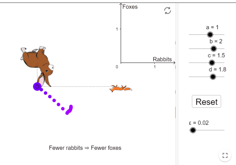

Here is the old Foxes and Rabbits chaotic behaviour.

sophiecentaur said:
Cool demo.
You can have a population of negative rabbits, a population of negative foxes and even both! :oldbiggrin:
Screenshot of a GeoGebra Lotka-Volterra predator-prey simulation with axes Foxes and Rabbits, sliders a=1, b=2, c=1.5, d=1.8, and a caption reading Fewer rabbits ⇒ Fewer foxes; a rabbit and fox sprite sit beside a purple dotted trail.
(But it stops being chaotic and degenerates to runaway growth of negative rabbits.)
