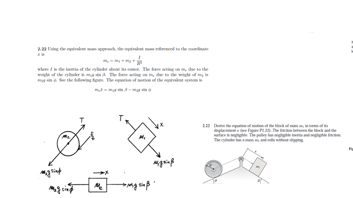

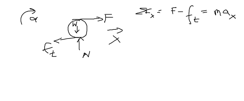

Why is ft (the force due to the friction between the cylinder and the ramp) not included in the equation of motion?
Because the cylinder "rolls without slipping".
For this situation, is my Fx equation of motion not true then?
