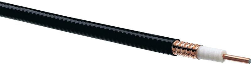

lets choose my fav cable for the 144MHz to 1300MHz (1.3GHz) LDF4-50A
this is 1/2 inch diameter ( maybe a tad more)
solid copper or sometimes copper clad aluminium, centre conductor, foam dielectric and a copper outer conductor

I have also often used its big brother on commercial installations, LDF 5-50, 7/8 inch diameter ( close enough to 1 inch dia)
the lowest attenuation is achieved by having an all air dielectric, but this is impossible in a coaxial cable as there needs to be something to support the inner conductor in the centre of the cable. One way around this is to use a spiral of Teflon. This keeps the 2 conductors uniformly separated but still achieves a dielectric that is >80% air. See the centre coax in the pic below
