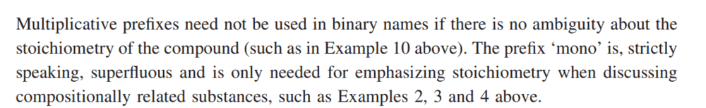

Why is HCl called Hydrogen Chloride (by IUPAC naming) and not Hydrogen Monochloride? It has a polar covalent bond (not ionic).
Covalent bonds have a prefix on the last name according to IUPAC.
The difference in electronegativity between H and Cl is about 0.96, well and truly below the 1.7 generally regarded as the ionic/covalent border.

Red book says the IUPAC name is hydrogen chloride. I am not sure why though.
I feel like Red Book IR-5.2 explains it.
Is this the bit that explains it..? (from IR 5.2)
That's my understanding.
Ok thanks Borek, very helpful!
